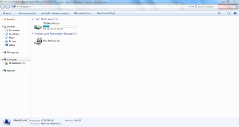

Hello all, I am new to these forums so please forgive me if I put this post in the wrong area or something of that nature.
I'm running a 2 month old Toshiba Satellite PC, when suddenly all of my Partitions, except for my C: drive disappeared. My computer also failed to recognize my CD/DVD Rom drive, however, after searching around I was able to find a lot of people with the same problem and recovered that Partition and the use of the drive by deleting the upperfilters in my registry. But the other Partitions are still gone and marked as inactive in my Disk Management. This is what I am looking at:
As you can see, it shows an additional two partitions, but they cannot be made active by right clicking them. When I right click them, all options are "greyed out" making it impossible to preform and actions.
I tried using a couple partition recovery softwares, but to no avail, because I am not trying to recover lost partitions, I am trying to activate partitions that are already existing. I have norton 360 installed and ran several anti-virus programs that came up cold. However, I did find one gentlemen on youtube, that had the same problem and fixed it by restoring the computers factory default settings. This is the video: https://www.youtube.com/watch?v=G0qENIBLo5s That's almost identical to my problem, and like the gentlemen in the video states, there does not seem to be a lot of info available to this particular situation, unless I missed it.
This course of action seems a little drastic to me, and a bit risky, so before doing this, I wanted to get the opinion of this forum, and see if some of you individuals more knowledgeable than myself can help. Keep in mind, I'm ignorant to a lot of this stuff, so please explain gently.
Thank you in advance, Brandon.

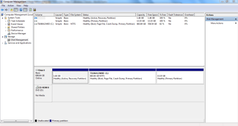

The only partition I see which is lost in your Disk Mgmt screenshot is the 13.33gb one:
245151d1355184041t-all-my-partitions-disappeared-i-cannot-make-them-active-capture.png
Recovery is apparently intact although it's files are always hidden. You can check by unhiding System and Hidden files at Control Panel>Folder Options>View. But it's marked Active therefore booting Win7 so if it will start then that partition is intact.
What's missing also is the System label on the Recovery partition. Did you run the 3 Startup Repairs I suggested to see if that resolves?
What's the problem? Partition table looks fine. It lists the two partitions as 100% free because it doesn't know it is a ntfs partition. Did it know before? Were drive letters assigned? Please do in elevated command prompt:

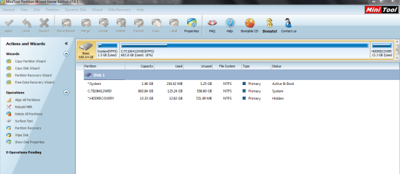

Okay, when Partition Wizard finished my computer Blue Screened, it said that a problem had been detected, and it was shutting down to prevent damage. It gave a name to the error but the computer turned off before i could write it down. However, I had just finished snipping the results, so here is everything, including my disk manager screen and my computer screen.Capture.PNG

What's wrong with the output?? It looks quite normal to me. The 13.33GB partition is just "hidden" as it was always most likely. What are you trying to achieve?

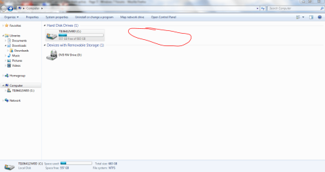

I was worried when all my partitions, except for my c: drive disappeared. I could not even use my CD/DVD drive, the computer did not know it was there. I was able to recover that by following the many fixes posted all over for that problem. But my D: partition never appeared again in the "my computer" screen. So I mentioned this concern on this forum and posted a picture of my disk management screen to ask if anything was amiss, and Greg gave me some ideas to try to fix it.
However, I just got really scared after running the partition wizard, because my computer has never "blue screened before." I am obviously ignorant when it comes to this, what do you think I should do, or are you saying there is no problem?
A letter was assigned to the recovery, it was D: and it disappeared, if that is normal, then I have no problem, but Greg told me to try a few things.
Yes sir, I had a D: partition, I guess thats what I meant, the CD/DVD drive disappeared as well and I had to go into the registry manager to fix it, I learned how to do that in this forum.
If I'm confused, and just fighting a battle that does not need to be fought, then please tell me, I just want to make sure my computer appears healthy from your end.
