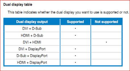

AND chipsets with onboard AMD video have been working like this for quite a while now, started with I believe the 690G. My motherboard with the AMD 780G chipset (and HD 3200 onboard) also has this feature/option to use the onboard in conjunction with any ATI/AMD video card, to be used for extra monitors or it can be run in Crossfire with a couple of select cards (HD 3450 in the case of mine, the HD 5450 or HD 6450 with the newer 880G chipsets). There is a setting in the bios in addition to enabling the onboard video called Surround View, which is the one that allows for the onboard and a card to be used at the same time. Despite the feature being a part of the chipset it is still up to the motherboard manufacturer to implement it in the bios; seen quite a few posts from those with a HP AMD based system and HP has either hidden or out right disabled it in the bios.
I had a look at the manual for your motherboard and that option isn't present but the feature still is. At a guess I would say either AMD changed how it works, or Asus has removed/hidden the Surround View setting while leaving it enabled by default (the setting is still there to enable or disable the onboard though).
In the discription, how did you know that this card would work (compatibility) chipset wise? Just it being ATI?
That is pretty much it, it will work with any AMD video card. Crossfire using the APU (video card built into the CPU) and a video card on the other hand is a bit different and will only with with a few select cards. You can see which here,
AMD A8-3850 APU Review: Llano Hits the Desktop - Page 7
As for the audio all ATI/AMD video cards since the release of the HD 2xxx series of cards have all had a Realtek audio chip on the card for audio over HDMI, and works independently of any other audio device (onboard or actual sound card).
