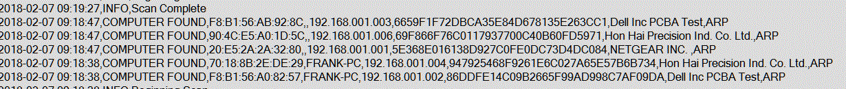

Thanks for the responses and suggestions Jim and samuria - I did a scan using the app "Whos on My Computer" it listed 5 devices - 4 of which I could readily identify. See attachment. Of concern was a voiced comment that kept repeating..."Unknown Computer" Not sure exactly what that means or what to do about it. I note that there are devices ...001,...002....003....004 and 006. Wondering why ...005 skipped?

I believe what you mean by "001,...002....003....004 and 006" refers to the last number of each device's IP address. It might be easier to follow if you look at it like this: 192.168.1.1, 192.168.1.2, 192.168.1.3, 192.168.1.4, 192.168.1.6. I wouldn't worry about 192.168.1.5 being missing from the list.
The two Dell listings both begin with "F8.B1.56". Dell has registered that as one of their network adapter MAC address series. So any network devices starting with "F8.B1.56" is a Dell device.
Apparently Hon Hai Precision has at least two MAC address series registered: "90.4C.E5" and "70.18.8B".
The Netgear device is either a network device or the router itself. Obviously Netgear has registered "20.E5 2A".
The question I would have is, why are there two Dell devices and two Hon Hai devices? Your computer is obviously a Dell, and it apparently has an Ethernet network adapter and a wifi network adapter, and both are connected to the router. Either that, or you have two Dell computers. Not sure about the Hon Hai devices.
To find out what you are dealing with, go on each computer, open a command prompt, and type ipconfig /all [ENTER]. You will see all MAC addresses listed on the screen; you can then compare to what is shown in the above listing. Whatever you cannot account for, you can log onto your router, go into the setup area, and tell it not to allow those MAC addresses. Doing this will keep out most people, but a determined hacker would not be stopped by this.
Where is the unknown device? I don't see it in your screen clip.

Thanks Jim, you are correct in delineating the devices. I have the following devices - 2 identical model Dell desktop pc (mine and my daughters); I have an emachine laptop (possibly one of the Hon Hai Predision devices), a Netgear router, but the second Hon Hai is a mystery. Could possibly be an LG tablet that my son gave to my wife last year which see has never used? Will run ipconfig /all to check on the laptop and the tablet.
