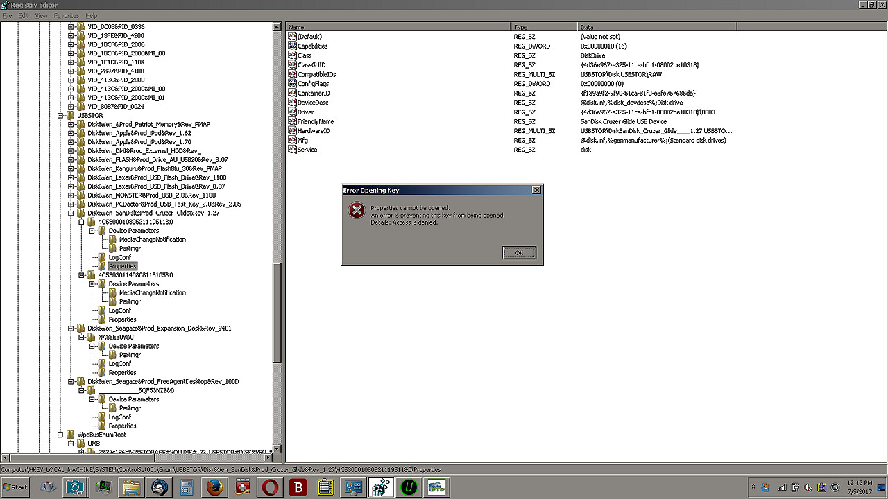

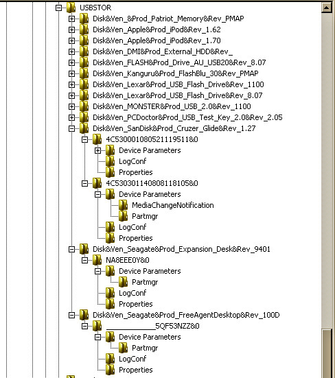

I don't know where those sys specs you're referring to are. I went through regedit and found one reference to ASC which I deleted. The program itself was deleted - when I found it with Uninstaller.
These are the USBSTOR reg settings. Everything listed is correct. What's there that's preventing it from showing? I also get another error when I attempt to access "Properties". Images attached.

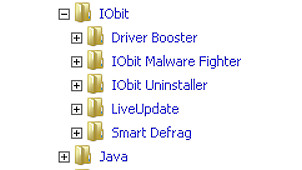

I will look for Malwarebytes as that was or should have been deleted a long time ago.

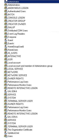

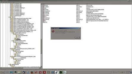

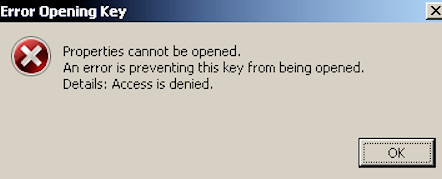

I'm rusty at this. The images referred to are attached for your review and reference.

Megahertz07, I see that and located those programs on a different drive. They've been deleted. I restarted and still see that Malwarebytes and ASC show up as my Antivirus. I'll have Bitdefender clean it up.

Microsoft says I need user MpsSvc
According to Microsoft - https://support.microsoft.com/en-us...s-do-not-start-in-windows-vista-and-windows-7
There were several things I needed to do in the RegEdit program to set permissions. Everything went as directed with the exception being this instruction:
  1. "Browse to the following key: HKEY_LOCAL_MACHINE\SYSTEM\CurrentControlSet\Services\Dhcp
  2. Right click the key, then click Permissions, then click Advanced.
  3. Under the Name column, click the one that states MpsSvc, then click Edit."
There is no user, group or other that contains "MpsSvc". The image Attached is the entire group of potential users; none of them indicate they contain or are that file.
There was another issue with Firewall, but that's not a problem.
