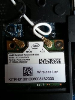

Can you have a look at what wi-fi card you have? More often than not they contain the bluetooth module too.
Should be behind a removable cover under your laptop, and will look roughly like this (can be shorter and have less cables) There should be no need to remove the card from its place, just remove the cover to see it and the sticker on it.

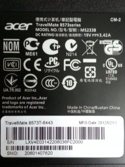

Tis a travelmate 8573T-6443
"This Device contains Bluetooth module ATHEROS AR5BBU22"

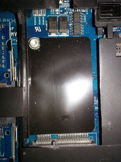

It goes on about the serial numbers and such. although i noticed it lacks an FCC Logo. Instead, there's an ANATEL logo, which i think is the FCC of Brazil, or something like that. I'm uploading all the pictures I just took of my wireless cards. Don't bother asking for more because there's really nothing else to see, unless you want me taking apart the entire unit to hunt for the module. All I have to work with is this one panel that houses the hard drive, RAM, wireless card, and the empty port that seems that it could hold a bigger wireless card.

The empty port is a mini-pcie port. Can house anything with a mini pci-e port. GPS, bluetooth, wifi, TV tuner cards. Does NOT run SSDs unless they clearly state that they run on a mini pci-e port. Most try to trick you saying pci-e SSD because they have the same form factor and size, but they actually use another kind of port (that resembles mini PCI-e).
If nothing else works, I speculate that the empty slot contained the bluetooth card that was removed by someone.
