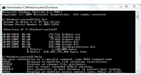

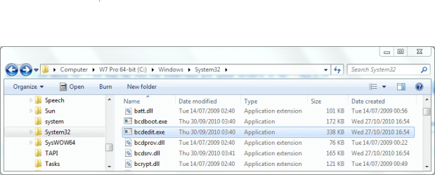

Yes, it is there. Here's a path copy: C:\Windows\System32\bcdedit.exe. I just tried the full path in the command window, and I tried the full file name. Nothing. I definitely am the administrator here.
I had another odd command window occurrence yesterday. There was a file (rstrui.exe - system restore) that I could plainly see in Explorer, but no DIR command, with Archive switches, would show it in the command window. Let me see if that's happening here too...
Indeed, this seems to be the problem. Here's the output:
C:\Windows\System32>dir bc*
 Directory of C:\Windows\System32
07/13/2009  08:11 PM            80,896 bcrypt.dll
07/13/2009  08:17 PM           249,680 bcryptprimitives.dll
               2 File(s)        330,576 bytes
               0 Dir(s)  146,007,564,288 bytes free
C:\Windows\System32>dir /a:s bc*
File Not Found
C:\Windows\System32>dir /a:h bc*
File Not Found
For some reason my command window is not seeing system files.

Ok, here's my problem. I just opened an elevated Command Window, and now I can see the system file without even using the a:s switch, just as you can. I don't understand why I need to take that step, however, since I am an administrator (and I just double-checked that). I've never had any problem doing anything via the command window before yesterday.
Thanks,
p.

So you can now access the file?
This is to do with privileges, and is a good reason for not disabling UAC. Although you may be running as an Administrator, you are only running with standard privileges. In order to run as a true Administrator, you need to elevate.
Think of this analogy. You and several others work in an office (representing standard privileges), inside which there is a locked cupboard (representing elevated privileges). Everyone has a key to get into the office, but only you (as an Administrator) have a key for the locked cupboard. If you wish to access the cupboard, you can simply unlock it (this is the equivalent of confirming that you want to run in elevated mode). For the others, who do not have the key, they need to ask you first (equivalent to entering a name and password of an administrative account when prompted).

Yes, I have command line access to the file now. What I don't understand is that I've had the machine for three months and have done countless installations and work under the hood, including via the command line, and never once did I have to elevate the window. And I've changed nothing in privileges in all that time, as I'm aware.
I wonder how this affects the command window in Safe Mode. That is where I would want to invoke System Restore in a dire emergency. There must be a way to elevate the window there too.
IAC, thanks for your help.
