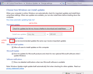

Nothing special honnybee if you are happy with Avast then stay with it though there are plenty of free ones you could use - of course some that I would not use myself. If you want to use another one just say and we can let you know what there is
Now I would be careful with updates if I were you there is a lot of nonsense gong on with Microsoft adamant that we should all go Windows 10.

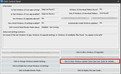

Now if you do not want that then I suggest you run the batch file (the second one) from this to prevent an upgrade to 10 Upgrade to Windows 10 Update - Enable or Disable in Windows 7 or 8.1 - Windows 10 Forums I also run this on my desktop to get rid of a lot of the 10 related updates from Microsoft.
Make sure you set updates too to what is in my pic and do watch for update KB3035533 reappearing all the time - do not install it.
I also have this on my desktop - see pic to know what to use Ultimate Outsider - Software Downloads < only use the Control Panel

The registry setting is helpful if you don't want to upgrade to Windows10 and like ICIT2 I also have the GWX monitor installed.

I just made the recommend installations, so taking your guys advice in mind will that be enough to protect myself from the more serious infections out there. I'm also a bit worried with the time I was locked out of my computer important information was taken from my computer, I've read zeroaccess is used from remote users, is it possible that the individual accessed my email account reason I ask is usually when I shut down my computer I dont always logout my email. Am I being overly suspicious about this and how best can I protect my personal information.
