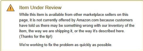

Amazon.com has this to say on your dock.
That I think is a more polished way of telling that all is not well with that dock from the customer reports.
You may try the dock on another known working PC. If you encounter the same problem/s it would confirm a serious hardware problem and you may have to take it up with the Thermaltake Technical Support.

Great find, jumaniji! I've never seen such a thing on Amazon. Hopefully the OP can return it for another product.

WELL CRAP
it has 1600 reviews on newegg! Oh well, I'll wait for tech support to contact me.
Thanks for the research.
EDIT: they replied. Said there might be a bad controller w/the dock and to return it. They also asked for the serial # so I gave them that. Maybe there is a bad batch.
