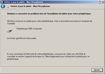

Hello, I have an issue with a brand new Bleu Yeti Mic.
This one is detected by Win7 as you can see on the file attach, but Windows can't find a driver for it.
I tried this mic on another computer with the same hardware (motherboard, etc.) and the same operating system (installation + driver) and it works fine.
I updated all my drivers with Driver Booster but it doesn't change anything.
The mic still detected but no driver is found. I tried to uninstall it to force detection, without more success...
I think the driver needed for the microphone is not missing but corrupted. Does anyone know which driver(s) I need to remove and reinstall?
Or better is someone know how to solve this issue ? :)
Thanks

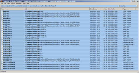

I'm curios if you have the dlls and sys files on the computer. Download and install the program everything.exe from here (Don't use the lite version).
Now in Everything go above to Bookmarks | Organize Bookmarks | and import the audio_drivers.csv CSV file attached here in a Zip file.
Do you see what I have in this screenshot?

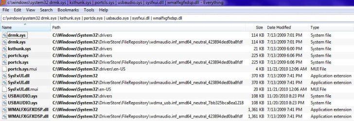

These are the drivers for my USB microphone - a Tonor Q9. Like the Yeti, my microphone was just plug 'n play. So I'm assuming the same files will be used.
Now, even IF those dlls and sys files are on your computer, the driver file its self for the Mic has to create the link to make the Mic work with those dlls and sys files.

Thanks for the tips. I think all drivers dlls and sys files are well installed

When I do that I have this error (I translate it):Windows found driver software for your device but encountered an error while attempting install itUSB Composite DeviceThe specified path is invalid.

When I uninstall the Blue Yeti Mic with USBDeView and then reconnect it, a small window appears:
Blue Microphones ... Looking on Windows Update in progress.
Then
Blue Microphones ... No driver has been found.
