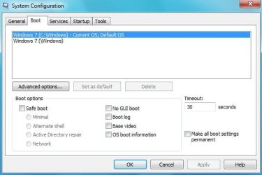

I ran "msconfig" then opened the Boot tab. There are two Windows 7 listed there. The top one says Default but other than that they are the same. Before I do anything I would like to make a copy of the "boot.ini before deleting anything.
How do I get rid of the one file that is causing this??

2. When I run msconfig there are two Win 7 files indicated as below:
It looks almost identical to what Win XP would have looked like with two boot.ini files.

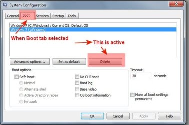

1. Why can't the second line of msconfig be deleted. It has that option. The first line does not have the option to delete.
2. Why does the double entry occur and how can it be prevented. I even resized the partitions before installing and definitely formatted the Cdrive??

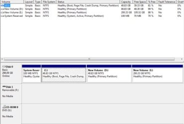

Please provide a screenshot of diskmgmt.msc with all volumes clearly shown and all text legible.
The questions you are asking cannot be addressed without benefit of the information contained there.

Here is the screen shot of disk management:
Your active partition is 100mb reserved by Win7 during install.
That means the boot files are on that partition.
Is your W7 installation on C: ?

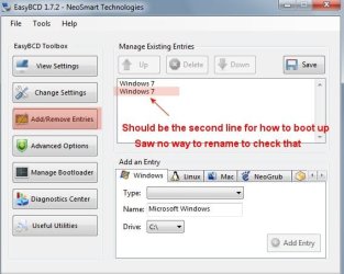

Here is what easyBCD looked like:
The top item should be the default one and the bottom one will run you in circles if it is chosen to boot with.
I saw no way to rename the files at all and if the wrong one is deleted, Windows can not be opened.

Yes Windows 7 is instaled on C drive.
Geez, :sarc: there is nothing wrong with doing some fiddling around for yourself.
That's how most of us learned.
Click on "change settings"
Then you'll be presented this screen.
Click on "chose an OS......." dropdown and select the one you want to change the name of.
Change the name in the name box, and click "save settings".
good luck
