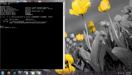

I've tried over and over to remove this trojan virus Microsoft Security Essential will not remove it...However it will detect it once the computer has been started and then every 3 minutes the notification pops up via MSE saying pc at risk threats detected. Then its lists what I've typed in RED fonts above.
I've taken one screen shot of the of MBRcheck.exe scan and I will attach it. Also I've taken one data log of aswMBR.log scan and will attach that as well.

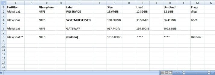

Good afternoon Petey,
Listed below is exactly what I see after running the( HirenBootCD ) on my desktop.. I attached the information After putting it into Excel and screen capturing it. So that it is organized. This the information displays on screen of the partitions on my Gateway PC. I'm playing it safe and do not want to delete any partitions myself.. for obvious ramifications will result. Have a look at the the information below and advise me what to do next once you get a chance and what to keep and want to delete.
Thanks for your expertise in these matters,

The partition that says (Hidden) is the partition that contains the virus. Delete the partition using Hiren's BootCD. Download and burn Windows Defender Offline (WDO) to a CD. Immediately after deleteing the partition, boot-up WDO and run it. It should completely remove the virus. After booting into Windows, go ahead and run a virus scan with your regular AV just to be sure.
http://windows.microsoft.com/en-US/windows/what-is-windows-defender-offline <-- WDO

Petey you are the SEALS TEAM 6 of the PC world !!! YOU F8CKING ROCK!!!
I DELETED THE partition you directed me to and rebooted as asked then ran the WDO and you are 100% correct sir it did remove the virus, No let me call it what it really is... ALUREON.E is the HIV of the PC world. I been up 38 hours no sleep looking for a cure and you had the answer.:D
