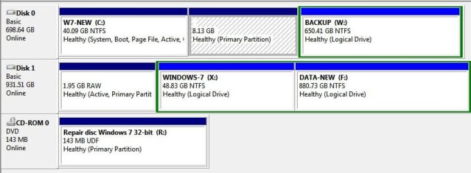

Dear folks,
I have 2 HDDs on my system.
Disk 0 has 3 partitions (1) W7 (another installation), (2) DATA, (3) EMPTY for Linux
Disk 1 has 3 partitions - (1) Win XP, (2) W7, (3) DATA
I boot from one disk or another (via switching the boot order in BIOS) depending on what system I need to use.
Yesterday, i was installing UBUNTU on Disk 0 partition 3, and when installation asked me for a SWAP partition I set Partition 1 of Disk 1 since I do not use WinXP anymore. Linux installation was successful and it marked that partition as SWAP type, however...
When I tried to boot W7 from Drive 1 it said "Operating System is missing".
I tried System Recovery's bootrec.exe /fixmbr /fixboot but it did not help.
What would you recommend to make it boot W7 from Disk 1 partition 2?
Thanks.
Windows 7 Ultimate x32

Will you please post a snip/screen-shot of the entire disk management drive map so we can see what you have going on and be sure to provide a list of what OS is on which partition/HDD.
In the Windows start menu right click computer and click manage, in the left pane of the "Computer Management" window that opens click disk management and post a snip of that.

What I need is to make W7 boot from Disk 1 Partition X from the screenshot.

First off, Windows will not boot / is not able to boot from an "Extended, Logical" partition, you will have to convert the partition to a "Primary" partition; are there other partitions to the right of that "Extended" partition?
Have a look at Option Four in this tutorial at the link below to change from logical to primary, if it's possible depending on if there are other primaries on that same HDD, there can be only 4.

"Is there another boot manager on the "Disk 1 partition 1"?"
Before I installed Ubuntu it was W7's boot loader. Now it's GRUB that also boot W7.
On Disk 2 partition 1 it was WinXP, then dual boot WinXP/W7. Now - nothing :-0
Well, as I said before the WinXp/W7 dual boot loader was on Disk 2 partition 1 before I screwed up with SWAP space. I thought that I need to fix MBR on Disk 1 regrdles on what partition type W7 is installed...
There are no more partitions to the right. these are all that I have.

You may have to move the data off the data partition and delete it before PW CD will allow you to Modify>Convert to Primary the logical partition containing Win7 on DISK1.
Once it's converted then Modify>Mark Active, set DISK1 as first to boot in BIOS setup, boot the Win7 DVD Repair console and run Startup Repair 3 separate times with reboots until it starts.
You would be much better having your Win7 installations on one HD booted separately via BIOS (the smart way) with Ubuntu on its own HD. GRUB will corrupt Win7. Look at the Move feature on PW CD to copy your Win7 partition onto the Win7 HD. Then use EASYBCD 2.0 to set up a Dual Boot on the same HD for both Win7.
Well, I would not worry about GRUB since it's on another physical drive. As i said before - I boot from different drives by swithching the boot order in BIOS. So we need to treat my problematic disc as a separate isolated system.

Folks, I do not quite understand why you think that logical partition is a problem. before I screwed up with SWAP space the WinXP/W7 boot loader was on DISK 2 and booted XP from Partition 1 and W7 from partition 2. My understanding is that boot loader is in MBR regardless on what type of partition the WIN system is installed. Am I incorrect?

I probably confused you with my description that differs form the screenshot. I edited the original post to match the screenshot, maybe it'll be less confusing.

Have a look at the tutorial at the link below, you will have to mark the partition as "Active" after it has been converted to a "Primary" and then run the startup repairs to get Windows booting.

Well, but it's already Primary and Active! Do you see that on the screenshot? Or am I missing something?
Here disks are in the reverse order. What I need is to make W7 boot from Disk 1 Partition X from the screenshot.
Is this not correct?
" What I need is to make W7 boot from Disk 1 Partition X from the screenshot"
That's correct. but please re-read the original post - I edited it to match the screenshot so that it would not be in reverse order. I may need to remove those confusing posts about reverse order now... Sorry!

PLEASE, just start here and show what you neeed, don't edit anything that's TOO confusing!
Ooops, it's too late, i edited. But starting over:

Dear folks,
Disk 0 has 3 partitions (1) Windows 7 (another installation), (2) DATA, (3) EMPTY for Linux
Disk 1 has 3 partitions - (1) Win XP, (2) Windows 7, (3) DATA
When I tried to boot Windows 7 from Drive 1 it said "Operating System is missing".
I tried System Recovery's bootrec.exe /fixmbr /fixboot on Disk 1 (!) but it did not help.
What would you recommend to make it boot Windows 7 from Disk 1 partition 2 (drive X)?
So you need to get "Disk 0 C:" booting?
You need to run 3 separate startup repairs with a system restart between each repair to create boot files to the "Disk 0 C:" while it's the only HDD connected.
