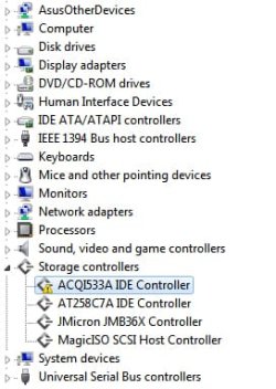

This shows as having a problem of some sort. I uninstall it but refreshing the device manager just shows it again. So what is this exactly? Anyone know?

I see you have Magic ISO.
Do you have also Daemon Tools or Alcohol 120% installed by any chance?

Ah yes I have, are they conflicting?

This is what Google search gives me:
Your search - ACQ1533A IDE Controller - did not match any documents.

That's what I thought. this ACQ file is a part of it and another part of Daemontools (SPTD) is known to cause trouble with Windows 7 (including BSOD's!)
(They have usually names starting with A followed by 7 random alphanumeric digits, that's why Jacee wasn't able to find anything about it.
So your best bet would be uninstall Daemontools, then remove SPTD like so:
To remove SPTD, simply download SPTD setup file "SPTDinst-v178-x64.exe" for Windows XP/2003/Vista (64-bit) [720,952 bytes] and execute it.
In dialog that appears press "Uninstall" button and then SPTD will remove itself from your Windows installation.
If you want to install it again then execute same setup and press "Install".
You can check it out here: DuplexSecure - FAQ
There are other Virtual Disk drivers that don't rely on SPTD try to use them they usually don't cause half as much trouble ;)

Thx, the problem has gone away in device manager. Much appreciated.
