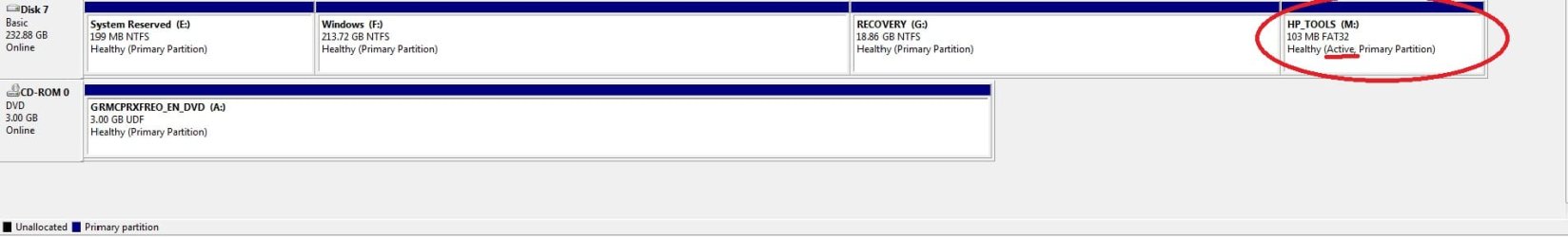

Hey all,
I'm helping a buddy of mine repair his laptop (we've all been there before!) and I'm stumped. He claimed he didn't do anything wrong to it, but apparently, the laptop displays the "BOOTMGR is missing. Press Ctrl Alt Del to restart". I've tried the following, all to no avail:
Ran Startup Repair 3 separate times - it either found problems it couldn't repair, or repaired the problems, which didn't help.
bootsect /nt60 c:
BootRec /FixMbr -
BootRec /FixBoot
BootRec /ScanOs - I get the message "Total identified Windows installations: 0"
BootRec /RebuildBcd - I get the message "Total identified Windows installations: 0"
sfc /scannow - the scan won't run at all. I get a "Windows Resource Protection can't run now", or something similar
I removed the drive and hooked it up to a couple of different Windows machines using different drive docks just to be sure the drive wasn't bad. It mounted with no issue, and the drive had three partitions: one with the main Windows files on them, one labeled "RECOVERY" which is probably an OEM partition, and another 200MB partition which I assume is the Windows 7 System Protection partition.
I ran chkdsk on the drive, and it ran without issue, however when it reached the end, the scan locked up, and chkdsk wouldn't finish, even after several hours, so I canceled it.
I've also checked the SATA cable in the laptop, and it's fine. I've also checked the drive for viruses with AVG, but it came up clean.
After attempting to manually repair the bootmgr with the commands above, I decided to get a little more in depth. I attempted to copy over the bootmgr file from the Windows 7 isntall DVD that I have, which didn't help.
I also decided to follow the advice from EasyBCD's website on recovering the Windows bootloader from the DVD. Unfortunately, none of that worked either.
I decided to move the active partition from the System Reserved partition to the primary Windows partition, so that it would simply the process of rebuilding the bootloader. I've included a screenshot of the drive from Disk Management for reference. It's attached at the end of the post.
After making that active, I tried running the command prompt repairs again, but no luck. However, after I installed EasyBCD, I decided to try rebuilding the MBR and bootloader files on the Windows partition using that program. I did have some better luck here: after starting Windows Startup Repair, it recognized a Windows partition, however it reported the installation as being 0MB!
When I attempted to reboot the laptop, I got the error:
"Windows failed to start."
File:\Windows\system32\winload.exe
Status: 0xc000000e
Info: The selected entry could not be loaded because the application is missing or corrupt.
So it looks like I've traded one problem for another! The good news is that, before I used BCDedit, a partition on the drive was reported as being unallocated, and now it is reported as being a 100MB partition named HP Tools, and it is the active partition, not Windows. This leads me to believe that the partition was deleted, and I have since recovered it by rebuilding the bootloader info somehow. Unfortunately, it hasn't fixed the boot error.

Mark the System Reserved partition Active and then run Startup Repair - Run up to 3 Separate Times with only the Win7 HD plugged in to it's PC.
Under no circumstances should HP tools be marked Active. And the repairs will not work on the boot files on System Reserved (where they live) if it is not marked Active first so WinRE knows where to repair or rewrite the boot files.
If this fails work through the other steps for Troubleshooting Windows 7 Failure to Start

I marked the System Reserved Partition as active, but when I ran Startup Repair, it simply told me that it couldn't fix the problem. The specific error in the details list was that no OS was found or present.
I'm going to continue to follow the other links that you posted, and keep trying to get the main system booting.
I have made one discovery: if I mark the RECOVERY partition as active, then I can access the HP Recovery options by pressing F11 at boot without issue. Maybe I need to leave that as the active partition, and simply repair the others?

If Recovery was meant to be System Active there would be no System Reserved partition. But if you decide to rescue your files and run Recovery you can mark it Active to do so.
OK, thanks again for the suggestions greg. Sadly, I ran Startup Repair three separate times - with reboots in between each run - with both the System Reserved partition and the Windows partition marked active, using Diskpart in the command line to change the active partitions, but no luck.
Startup Repair still finds no bootable installation of Windows, but I know it's there! Maybe I need to post some screenshots of each partition's contents from the root directory, just so you have an idea of one each one is about.
I'm not sure if the System Reserved partition is really that. It was actually unlabeled, along with the Windows partition. I simply labeled them System Reserved and Windows because I assumed that is what each one is for. I have no idea if the 200MB is something that was created by my friend, or if it really is it, because it wasn't labeled when I got the laptop to work on it.
You are correct about the RECOVERY partition; I can always label that active to get into it, and the good news is that it has the lean OS reinstall option - without all the crapware - as mentioned in the Windows 7 - Troubleshooting Windows 7 Failure to Boot guide (emphasis added):

However, I did find a hidden directory at the root of the primary Windows partition, which used a series of brackets and parenthesis to create an emoticon that looked like a face smiling. My friend swears he didn't create it. Either someone else did as a practical joke, a program did it, or - as I suspect - it is the calling card of some virus or malware infection. Oftentimes malware will leave behind a calling card, and this could have been it. It definitely wasn't a normal part of the root directory of a Windows installation, even an OEM one.
Inside the directory were two log files, which I opened, but I couldn't make head or tails out of them. I should have saved them so I could upload them here, but it probably wouldn't have helped. I might try to recover them, but I don't think it is worth the effort, and I don't even know if it is possible now.
In any case, I feel that I must follow gregrocker's advice, and do a complete reinstall of Windows on the troubled drive. There simply isn't any other solution. I've followed an exhaustive list of suggestions both from this thread and website, and from the Internet in general. As I said, if this were a simple startup problem, I almost certainly would have got Windows booting by now. Instead, it appears to be some sort of other issue, especially with relevant files missing.
I even hooked up the drive to a working Windows computer, and started copying over the winboot.exe file (which was missing from the problem drive) and other system32 files. All well and good, but every time I copied something over, and tried to boot up Windows, I got yet another black-screen error message telling me something else was missing or corrupted. Last I checked, the International Language Files were gone.
Even if I did manage to get everything copied over and moved into its proper place on the drive, there still wouldn't be a guarantee that Windows would boot - or that it would even work properly if it did. As a result, a clean reinstall from the OEM recovery drive using the minimal install option would probably work best.
I've already pulled off most of the important files, so once I get MS Office reinstalled by retrieving the key somehow, then I will be ready to perform the reinstall.
