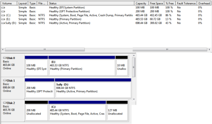

If you have a working Win7 now, then plug in the other drive and post back the requested screenshot for Disk Management - Post a Screen Capture Image.
If not then download Partition Wizard CD ISO, burn to CD with WIndows Image BUrner, boot it and take a camera snap of the full drive map showing all listings. Then use PW to Mark Partition Active the 100mb System Reserved (if you have it) or C, which is required before you should even bother to run Startup Repair - Run 3 Separate Times.
If you followed all of the steps in Troubleshooting Windows 7 Failure to Start then you should already have the PW CD since it is involved in several important steps which can't be ignored if you are doing everything possible to boot Win7.
As it is failing to confirm Active partiton means you haven't even reached first base yet. If it was fouling out during Diskpart, did you miss that I specified in tutorial you can use PW CD to do this?
http://www.sevenforums.com/tutorials/71432-partition-mark-active.html

You've installed DISK0 Windows 7 in UEFI (Unified Extensible Firmware Interface) - Install Windows 7 with - Windows 7 Forums mode.
DISK1 has the GPT protected partition which means it is also a GPT partition which can only sustain a UEFI install: UEFI BIOS vs. Legacy BIOS - YouTube. I dont' know why it has an Active flag if it is GPT. Maybe it's some kind of special Hackintosh install.
DISK2 is a normal MBR install as signified by the System Active flags on it.
Do you have the BIOS set for Legacy BIOS enabled or CSM Enabled or Both, with UEFI boot first? If not sure, look at those settings choices in BIOS setup and post back a camera snap of the expanded choices so we can see them (or write them out). Don't miss any settings, or include them all for us to see.

For that shot I didn't have the mac drive hooked up- I swapped it out for the drive I did a new install on. So that makes Disk 0 the drive I'm trying to get to boot up, Disk 1 the target for Windows Backup from when things were working, and Disk 2 the clean install I booted into to take this picture.

As far as I know none of the disks here should be affected by the Mac install- they were all up and running (minus Disk 2, the one I just formatted and did a clean install) before I did the Mac stuff, which has been running cleanly for a couple months now.
I didn't change the BIOS Boot Mode Selection from "UEFI and Legacy" while things were working. I've swapped between that mode and "Legacy Only" and "UEFI Only" some as I've tried different techniques to solve the problem.
There's also an option for Storage Boot Option Control which was on "Legacy First" (other options: Disabled, UEFI Only, Legacy Only, UEFI First). I switched to UEFI Only briefly to try something, but switched it back.
CSM Support is set to "Always", and the menu is greyed out and unchangeable.
Let me know if any other info would be helpful.
