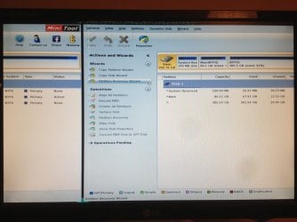

and by btw - this is the snapshot of PW. and when the 80gb is active (i did it before i saw your message) i tried rebuild mbr option. didn't help..
OK, I will try to.. I will let you know about the results.. thank you
