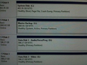

Yet, during the process, Win7 did not load my 2TB backup drive, and I had to go into Disk Management to configure it... All I had to did was map a drive letter to it. However, after that, I noticed that the drives' status are quite strange. The 2TB backup drive is indicated as "system" and "active", as seen in the image attachment...
(when I right click on the 2TB drive, the option to format it was grayed out.)
From my research, the "system" status should be on my C:\...

Hi Zomad,
That is normal.
It should be ok as it is.
However, I would make the win 7 drive system - it will be easier if you want to change your drives, and for backup imaging.

I did some checking...
It seems that I'll have to do some fixing with bcd editing...
Will give it a try after work today.
Not sure if a program called EasyBCD will be a better choice for such task..
Please let me know if anyone got any suggestion, thanks!
Windows 7 x64
EasyBCD is better if you want to use menus and buttons to do everything. BCD Edit does the same stuff but you need to know much more of the details.

I was able to change the system drive to C:\ with EasyBCD, and used diskpart to keep C:\ as the only active drive. It seems everything is in order now! :)
