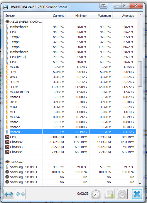

Ruler try this
Using HW Info
PART A:
You can test the volts on the PSU with HW Info HWiNFO, HWiNFO32/64 - Download < download the right bit version and close the right hand window select Sensors and scroll down to the power section where you will see what the volts are doing see my pic. In my pic the section (Nuvoton) with VBATT is a dead give away you are in the section for the rail voltages. There are other section titles and one that pops up often is ITE
Now the voltage on the different rails have to be within 5% =+/- of what is required or the machine will not work properly if at all.
See this for the rail voltage info
http://www.tomshardware.com/reviews/power-supply-specifications-atx-reference,3061.html (Section 2.)

Here is the screenshot for voltages while at rest
20hECH97HVAE
And here it is under load
20hERGJ5mybe
I can also verify the PSU fan is running. I'm not sure how to check the water pumps, the fans are so much louder it's impossible to hear them. I can confirm they have lights on though. This is all at idle, I'll try putting it under load and if/when it freezes check again.
