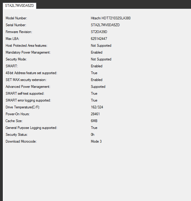

I just got one of these.
it says Files that help describe the problem:
C:\Windows\Minidump\041714-25506-01.dmp
C:\Users\Tommy\AppData\Local\Temp\WER-60107-0.sysdata.xml

It appears to be a HDD problem.
[COLOR=Red]KERNEL_DATA_INPAGE_ERROR (7a)[/COLOR]
The requested page of kernel data could not be read in.  [COLOR=Red]Typically caused by
a bad block in the paging file or disk controller error.[/COLOR] Also see
KERNEL_STACK_INPAGE_ERROR.
[COLOR=Red]If the error status is[/COLOR] 0xC000000E, 0xC000009C, 0xC000009D or[COLOR=Red] 0xC0000185[/COLOR],
[COLOR=Red]it means the disk subsystem has experienced a failure.[/COLOR]
If the error status is 0xC000009A, then it means the request failed because
a filesystem failed to make forward progress.
Arguments:
Arg1: fffff6fc40009a30, lock type that was held (value 1,2,3, or PTE address)
Arg2: ffffffffc0000185, error status (normally i/o status code)
Arg3: 000000012c5fa860, current process (virtual address for lock type 3, or PTE)
Arg4: fffff88001346758, virtual address that could not be in-paged (or PTE contents if arg1 is a PTE address)
Debugging Details:
[COLOR=Red]ERROR_CODE: (NTSTATUS) 0xc0000185 - The I/O device reported an I/O error.[/COLOR]
[B][COLOR=Red]DISK_HARDWARE_ERROR: There was error with disk hardware[/COLOR][/B]
BUGCHECK_STR:  0x7a_c0000185
CUSTOMER_CRASH_COUNT:  1
DEFAULT_BUCKET_ID:  WIN7_DRIVER_FAULT
PROCESS_NAME:  chrome.exe
CURRENT_IRQL:  0
ANALYSIS_VERSION: 6.3.9600.16384 (debuggers(dbg).130821-1623) amd64fre
Test the HDD using Hitachi Drive Fitness Test.
12 Free Hard Drive Testing Software Tools
Let us know the results.

WinDFT isn't detecting my hdd?

Try something else, like Seatools.
It appears like it is failing the long generic test but everything else passed. I also just experienced another blue screen. should I post some type of data or something?
