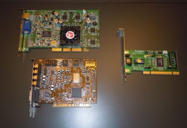

Some pics.....
I decided to try Wireless, so I went with a wireless card instead of the card card on the right of the last pic.
Anyways right now all the hardware appears to be working, but 98 is giving me fits about various missing files. In fact I can't boot with out a warning about these missing files, and even when I attempt to install drivers for the hardware I'm still prompted to install the 98 disk to find missing files. And in case you're wondering.... yes I have a legitment copy of Windows 98.....
So I don't know what's up right now... still a work in progress :)

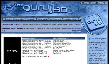

If you haven't found it yet the last 98 driver for that old 8500 can be found here,
Ati Catalyst 3.10 Win Me|98 download from Guru3D.com

Well I found the display drivers, spyre over at rage3d linked to ATI's site.

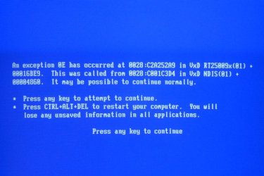

Well I finally fixed my issue with the wireless network card.... sort of :confused:
After fixing the NDIS VxD error using a Microsoft fix from here..... Windows 98 Second Edition Problems with NDIS Intermediate Drivers, then finally getting the Linksys Wireless software properly installed and finding my network... I was presented with the message "Windows 98SE and ME do not support PSK2 mode", meaning 98SE dosn't support the security mode i'm using. I don't use WEP, I use WPA for my security feature on the router.
Oh well.... looks like I have to use the LAN card instead.... which means cable all over the place :mad:

Don't you love those old NDis vxd errors! :roflmao: I put up with enough of that crap on the old dsl setup.
That certainly wasn't any attempt at WiFi but going through a usb adapter on the old version.
With a nic card in however there's hardly ever any drivers involved with the newer versions anyways unlike usb or wireless setups where you need some type of 3rd party driver set.
