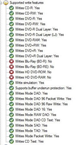

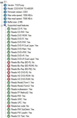

Where to begin a while back i got maybe 1 ruined dvd from burning but now evry dvd that i try burning doesn work.
Thot that maybe its a sofware problem so i used CDBurnerXP v4 3 7 and it doesn work. The error report sayed somthing about that this usualy happens if a dvd is poor quality. Nerro say's that there is an error when checking the data. I use the check if the compilation is burned option.
So im thinking that my dvd burner is broken. On a nother note i can read dvd,cd's normaly.
I shuld mention that some times when i burn the burner is making strange voices hard to explain.
In the pictures you can see what the program CDBurnerXP v4 3 7 say's about my recorder .
So bassicaly what do you think its wrong ? is there any way to test it ?

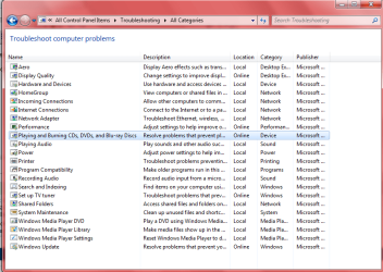

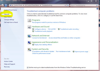

Type trouble shooter in start menu Search bar. Then click on "Find and Fix problems".
Left Snip.
Check mark box all the way at bottom toward left side "Get the most up to date".
Then click View all - I circled below in yellow.
Right Snip highlighted in blue click Playing and Burning.
Then follow prompts in next windows that come up as needed. :D
Never used it myself for your problem so results may vary with mileage. :confused: ;)
I hope that helps.

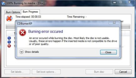

So i did as you told. Had a little trouble finding it since i use Slovenian langugage on my PC and not English.
Burned 1 dvd and it worked. But then the second dvd didnt. and i got this message:
