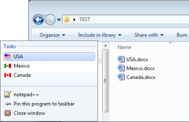

Seems like the only easy way is to use custom jump list creator. Like this one.
It is free, you unpin those 5 files, create a new jump list with this program and customize it as you want. It is free.

The only thing is that they would open in the default program.
On the example in the attachment those Word files are on Notepad++ jump list, if you click them, they would start in Word anyway, but not in Notepad++.
Then that wouldn't work for me.
I need for my custom program to open, not the Windows default association.
Sorry for confusion, you CAN run it with your particular application.
I have just double checked. There are two options.
Please check out screenshot. I used notepad++ as an example.

Yes, thanks a lot!!!
That definitely did the trick to get me exactly what I wanted!
Thanks so very much! :thumbsup:
