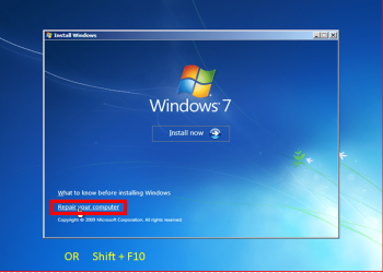

When I try to install from a full install disc it doesn't give me an option for repair or will it only give me that option when it sees whats wrong ?
Where do you buy your DVD from?
ME/XP/Vista/Win7
ME/XP/Vista/Win7
I have a system installed on both C and D but my important files are now on C. I want it to run from C, so do I still follow the above reply until it moves the flag back to the 100mb System Partition. I will await your reply. Thank you.
Update : Do I shrink D to unallocated space ? Which one do I make active System Reserved or C ? Quite confused. Don't know if I have a repair disk.
I gave you the steps earlier to do exactly what you want. It clearly says that once you move the System Active flags to C that you can Delete D and even provides a tutorial showing exactly how that is done. So why would you ask if you should shrink it?
To move the System flag back to System Reserved, first Mark the 100mb Partition Active in Disk Mgmt.
Then run Startup Repair - Run up to 3 Separate Times until the System flag moves to the 100mb partition.
You can then delete D and extend C to the right: Partition or Volume - Delete
Partition or Volume - Extend
You must boot the Win7 disk to run Startup Repair - Run up to 3 Separate Times or the Repair choice will not show up: How to Boot A Computer from CD or DVD - YouTube
