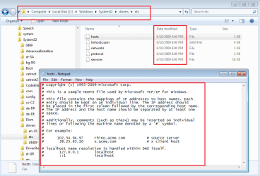

Yes, that is the place.
Please see if you have the default HOSTS files (like openminds suggested).
If not, I've attached one to this post.
You will just have to remove the ".TXT" from the end.
You might need this info if you don't see ".TXT" on the end.
http://www.sevenforums.com/tutorials/10570-file-extensions-hide-show.html
more info here:
http://www.sevenforums.com/tutorials/78266-hosts-file-use-windows-7-vista.html
Yup I checked that first, its all default nothing added
