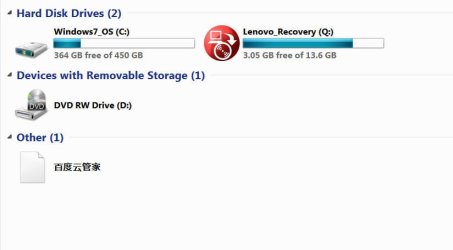

I have this hanging icon listed in catagory "Other" in MY COMPUTER. It' labeled in Chinese letters so I have no idea what it is even though I suspect it is from a USB driver card that was installed.
Anyway, it's not needed and I cannot figure out how to remove the icon.

post a screen shot of the icon with the text

here ya go!

If it's shown in Computer then the system thinks it's a storage. Chances are it's from a USB key that got removed. The "Chinese" letters may just be Unicode. Explorer has a lot of old code that likes ANSI.
I would install Unlocker and try right clicking to remove it.

Ok,,,I download Unlocker and went to COMPUTER, found the chineese icon, clicked on it and 1000's of entries came listed of what seems like almost every program on my PC.
How do I go about finding it?

It sounds like it's a "shadow" of another icon. Like it could be a messed up duplicate of drive C. Do you have a Restore Point from before the problem? It's likely something messed up in the Registry. But a registry fixer might mess up your system even more. A restore point would likely be safer.

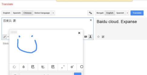

ok, the reason i asked for a screenshot is because you can actually draw the characters in google translate,
here is a screenshot of what i was able to decipher though i could not find the fourth one.
hope this may shine some light on it for you,

Hmmmm???
That was very informative.
After doing a search on Baidu, I found a bunch of crap in there and deleted almost everything.
By doing that, the icon disappeared and is now replaced by a folder. So now, I have to find the folder.
