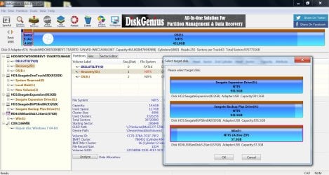

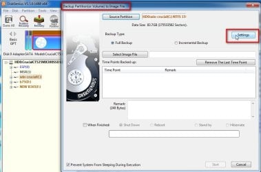

To SIW2,

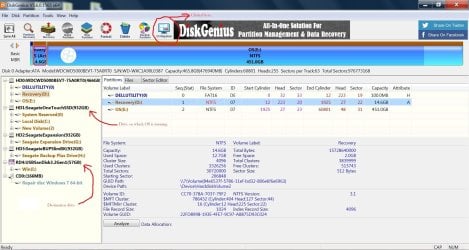

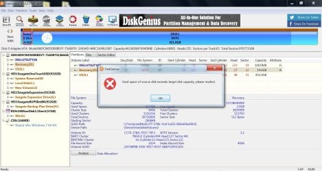

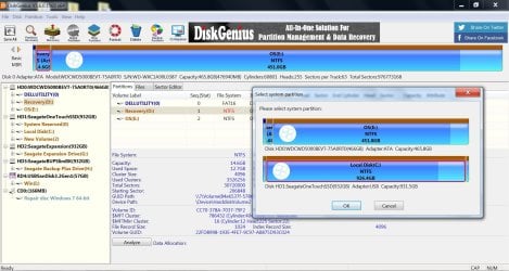

Here are the screenshots. Hopefully, I'm just not using Disk Genius correctly.
Disk Genius 1.jpgDisk Genius 2.jpgDisk Genius 3.jpgDisk Genius 4.jpgDisk Genius 5.jpg
To townsbg,
I'm not trying to exclude system files associated with the "users" folder and subfolders during migration. I merely excluded its size from my calculations for the needed disk space as I believe it is the only folder that contains my personal files. And it is my understanding that a system migration does not migrate personal files but perhaps I'm wrong.
Thank you both!

Os Migration will migrate all the used space on the selected source partitions.
You could try a partition image. That will allow you to exclude any files/folders you don't want from the image. But you have to know what you are doing, don't exclude any windows system files.
Then you restore the image to the target disk
tick the system volume information box to exclude it and click ADD to browse to any other files/folders you want to exclude

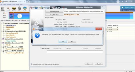

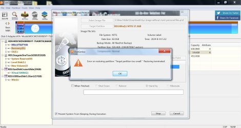

I'm now trying to recover the partition image, but I'm getting a prompt asking, "The Master Boot Record(MBR) has been changed. Do you want to restore it to the selected time point?" Sounds like I need to get this one right on the first time, but I don't know what the answer is. I'm guessing that I should want to swap the MBR in the image file for the MBR on the flash drive, which would mean I should select, No. I think selecting, Yes, would change the MBR on the flash drive to whatever is in the image file, which I don't think is what I should want. Do I have any of that right?

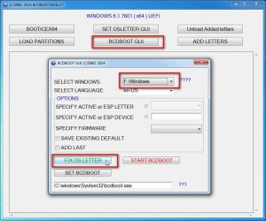

It is possible to boot win7 via usb but it needs a couple of registry changes.

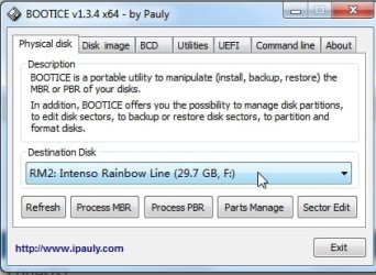

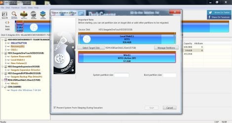

To samuria and SIW2,
I'm not yet at the point of trying to boot from the flash drive. I'm still just trying to recover the partition, but DiskGenius wants to know, "Do you want to restore [the MBR] to the selected time point?" before it will recover the image. But I can tell you that my active OS is running from an external SSD via USB thanks to the code provided by SIW2, so as far as I know the computer should be able to boot from the flash drive once the image has been recovered. And the flash drive currently holds bootable installation files for Windows 7 Pro x64. I just need to know if I should restore the MBR. I presume it means to restore the MBR on the flash drive to a setting in the image. But the setting in the image is for the OS on the external SSD. I'll also mention that DiskGenius made me boot from another drive just to create the image.

It still says "Target partition too small". The size on disk (on the source partition) of the image is 28.6GB. Does the size more than double upon recovery?
In your photo it says data size 82.0gb

Yeah, I know. Don't know what that's about.

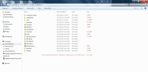

I thought the original uncompressed files didn't even add up to 32GB, but upon redoing the calculations I've discovered that the AppData folder in my user profile amounts to about 24GB. I can also account for a few more GB simply by being more exact this time, instead of estimating, so that still leaves 23GB unaccounted for. I'm providing screenshots of what I'm including in my calculations. The sizes are based on "Size on disk" in "Properties" for each folder. In the first screenshot, I'm showing the total for all items in the C: folder, except for "Users". The second screen shot shows the total for all folders in C:\Users, except for my user profile, Danny. The third pic shows the total for all folders in C:\Users\Danny, except for Downloads, My Music, My Pictures, and My Videos. In DiskGenius, I tick the box next to these folders to exclude their contents, shown in the fourth screenshot.
Any suggestions as to where to find the unaccounted for 23GB?

I assume that if you add up all the used space it is much smaller than the size of the partition. If so you might be able to reduce the partitions size to just a little more than is needed to hold the files.
Normally the parts of a files are scattered all over the drive unless the drive is defragmented. Even if this is done then certain system might not to be easily moved. In the past I have used a partitioning program that automatically defragments the drive and then reduces the partition down to just enough to hold the files. The process reduces the free space with the now unused space call unallocated.
Here is a simple diagram that shows the process. Note that partition contains both used and free space. Now the partition contains the same data but is much smaller.
