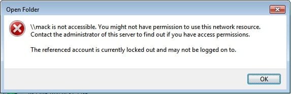

We are all DHCP and the server is a Windows Server 2000. We can see and access the Windows Server 2000 with no problems. When we try to access our NAS (Dell Powervault 725) we are prompted for our usual login credentials. After we successfully enter them and press OK we are asked to re-enter them like we typed it incorrectly. So we do and then after 3 attempts we are given an error message saying "You might not have permission to use this network resource. Contact the administrator of this server to find out if you have access permissions." I am the server administrator and yes i do have full R/W control over the server.
I have updated all drivers and BIOS and firmware on the NAS and I still am not able to successfully connect. I have verified that the Login Credentials are good by using them from an XP Box which has no trouble connecting. HELP! I do not know why it is failing to use these Login credentials.

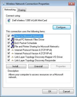

So these are my settings and it Occasionally works... I have included a Screen Shot of my Protocols installed for the network adapter (Wireless).

Yeah... good idea to try but it didn't work :(
I typed User: Mack\timryder as it should be and still nothing...
Here is what I'm seeing.
Your comment about letting Windows manage the user worked in addition to having the TCP/IP 6 protocol.. I noticed on of my colleagues laptops that he did not have this and it made the difference.

Yes they are... I verified that many times, I have also gone as far as to create a new USER on the NAS which is exactly the same login credentials as my W7 machine. No luck still
