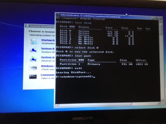

It wants you to restore a backup (which you don't have)... isn't it? If so: click on "use recovery tools ......... " and press next. Select "command prompt" as the recovery tool.
diskpart
list disk
select disk 0
list part
exit
Post results, or even better... post a camshot

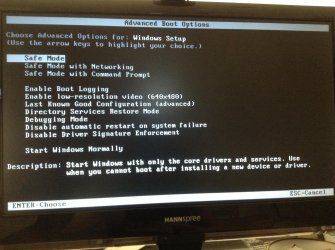

I'am able to boot in safe mode here are two pictures of the screen and of another when I hit escape.

Here's photo 2.

I only see 1 screenshot instead of 2!!! So safe mode works fine? After you select "safe mode" and press enter you see a lot of drivers loading? Last one is most likely classpnp.sys? After that you have to logon or desktop appears automatically?

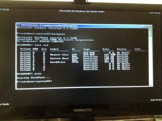

This is what I got when using cmd prompt. Sorry im using a ipad to post and reply at the moment.

diskpart
list vol
exit
Please post output as well. Disk 3-6 are most likely sdcard slots... irrelevant. disk 0=931GB and disk 2-3 are 465GB.

Heres what I got.

vol c: 931GB but status RAW!
vol f: 465GB but status RAW!
Is win7 located on the 1TB disk?

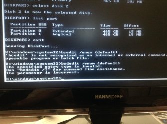

diskpart
select disk 0
list part
select disk 1
list part
select disk 2
list part
exit
post output
Post a proof you can boot in safe mode plz. Can't believe it.

bcdedit /enum  {default}
post output plz

Disk 0-2, I believe win7 was originally on the c drive.

Sorry wrong attachment

Post 14, I had a typo in a command.

bcdedit /enum all
strange there's no default.

As for proving I can boot in safe mode how would I go about doing that. I pressed F8 on startup and it it showed me the boot manager in safe mode one of the first attachments shows this.
