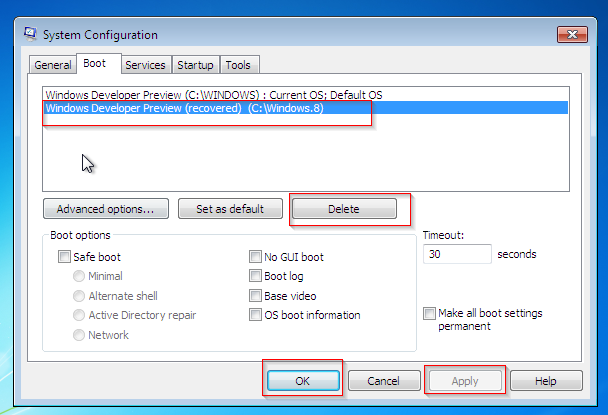

Start menu - run - type in msconfig - click the BOOT tab - delete the OS you are having problems with
Be sure to delete the right one

Hey mangoh - there's only one boot option in msconfig, otherwise I would have tried that already :P
