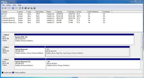

I finally got Windows 7 to install on the 2nd HDD after unplugging everything, installing via USB and fixing the MBR using this:
http://www.sevenforums.com/tutorials/20864-mbr-restore-windows-7-master-boot-record.html
Now my original HDD always gives me the error "The parameter is incorrect" when I try and access it in the new Windows 7 install. I'm currently running CHKDSK on it but it's going to take awhile. At least it's a step!

Try putting the HDD you installed Windows 7 on on the Master cable instead of the Slave.

I have all SATA drives so I don't believe there is a master or slave. I'm trying to just take my files off of the drive with EASEUS Data Recovery Wizard Professional and format but the remaining time is 233 hours, 57 minutes and 28 seconds, and still rising after already running for an hour and 12 minutes.

That just sucks big man, you have about a month's waiting time on that thing, my method worked for me 3 different times. . .

Is there any chance you cleaned your data HD? Was it plugged in during Diskpart cleaning?
If you'll post back a screenshot of your full maximized Disk Mgmt drive map and listings, using Snipping Tool in Start menu, we can take a look.
I don't believe it was connected during Diskpart, but it's a possibility. The time keeps going up but eventually drops quite a bit but then goes up again. Right now it's at 106:33:39 remaining. It's about 15% done but it's been running for 20:38:31. Here's the screen shot:
Disk 0 is my backup drive that I have some of my data backed up on (pictures, music, etc..)
Disk 1 is my drive I was able to install Windows 7 on and am using to try and recovery my data.
Disk 2 was my primary HDD I'm trying to save. As you can see, it's coming up as RAW.

You didn't wipe DISK2 as it still has the old SysReserved partition intact. though it is no longer Active so it can't interfere with booting Win7.
The RAW label often means corruption requiring Data Recovery since the OS is unrecoverable.
I don't know if we helped you attempt to repair this in another thread as there were multiple similar cases recently. Did you attempt to access your data to copy it out using Win7 DVD or Repair CD using this method: http://www.sevenforums.com/tutorials/93347-copy-paste-windows-recovery-console.html or by using Paragon Rescue CD? http://www.paragon-software.com/home/rk-express/
I hope your data is recoverable as it must be important to wait over a hundred hours to recover - have you confirmed any of it is in fact intact? Once you get it resolved one way or the other I would wipe the HD using Diskpart: http://www.sevenforums.com/tutorials/52129-disk-clean-clean-all-diskpart-command.html
I can't use the copy and paste method because when I tried to access the drive it says "Drive Letter: is unaccessable. The parameter is incorrect." I haven't tried the Paragon Rescue CD, but I'll give it a shot.
Yeah, I'm going to wipe it afterwords to make sure to start from scratch. I can't really tell if anything is still on it, I'm just hoping there is, haha.
