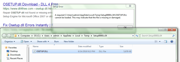

Hello everyone,
I'm having an issue where Microsoft Word won't launch. For a split second I see the loading circle and then nothing. This happens both when clicking on the program itself and when double clicking documents. I get no error messages. All other Microsoft Office Home and Student (32bit) programs launch without a hitch.
When attempting to uninstall or change the program to run a repair, I get a message stating:
A required C:\Users\admin\AppData\Local\Temp\Setup00001c34\OSETUP.DLL cannot be loaded. This may indicate that the file is missing or damaged.
(The Setup folder number varies.)
When attempting to install:
A required C:\Users\admin\AppData\Local\Temp\OWPACE7.tmp\Updates\OSETUP.DLL cannot be loaded. This may indicate that the file is missing or damaged.
This is the second time I've had this issue in the past month. The first time I had let a friend of mine clean up a program from off my computer and he deleted the registry keys in association with it. I then proceeded to install a program called Dayon!. I tend to keep my User Account Control messages turned off since I have a game that always prompts me. Installing Dayon! triggered an Action Center message stating that in order to turn on my User Account Control I would have to restart the computer. I thought it odd but just manually turned it back off again.
It wasn't until a few days later I discovered that Word wouldn't launch. After trying multiple things that failed, I did a system restore. Word didn't work right away but I was able to run a repair finally and all was well. I assumed something had gone wrong during the registry cleanup.

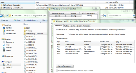

I wasn't sure which folder you were speaking about, but I did check permissions on the Setup folder that is created when attempting to uninstall/change Microsoft Office. I honestly don't know much about permissions as it's something I've never messed with but everything seems to be in order?

Its the folder were the file you need to check permission is that file on the install disk try copying it over the old one in case it's corrupted

I also took a look at the permissions on that folder. Everything looks fine.

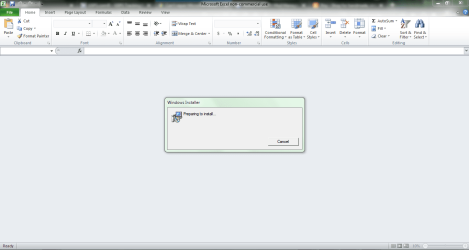

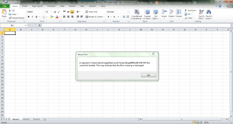

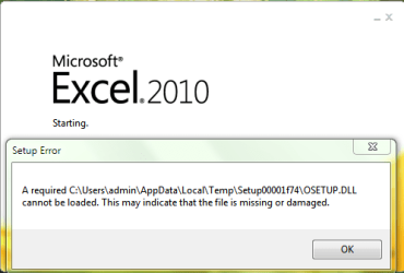

Thanks for the info Snick. When I have free time from work and family, I'll take a shot at it. Will have to download Win7 as it came preinstalled and I was only given a set of recovery discs. I haven't had any luck at manually repairing it so far and now the other Office programs are having problems. Unlike Word which doesn't do anything when attempting to launch it, Excel and OneNote actually attempt to launch but give me the error during startup. Then when it opens, I can't click on anything and it brings up an installer window before failing that and closing with one last error. Not sure if all my meddling caused this or there is a bigger issue at play. I'm worried it's the latter so a repair is probably just what the doctor ordered.
My only question as far as repairing goes is: Should I uninstall Office prior to running repair or just leave it? I imagine uninstalling it would be better since repair doesn't mess with programs? I have no other issues with my Windows (that I know of) so my only reason for repairing Windows would be just for Office. And if I do repair, I think I heard that it does affect drivers. I have some drivers setup for gaming purposes so that's something I'll have to keep in mind.
Thanks for all the help
