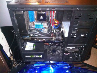

ok so heres my problem. I got my new GPU and its massive. so massive that I cant put my side fan on anymore without having to screw the fan on in an awkward way to get it to fit. but I got it on. the thing about the gpu is that its so long it cuts my case in half.
as of now I have 3 exhaust fans and 3 intake fans including the side fan.
this side fan is extremely annoying and loud but it provides light to the case, and I kinda like that.
so I tested the GPU with the side fan on and it got to 75C and than I tested with the side fan off and it got to 75C so the side fan here did nothing in terms of cooling.
what do you guys think I should do? take the side fan off or leave it on? if I take it off, what should I do with my other fans? should I change the direction of them or qwhat? or should I have the top 2 fans as intake?
if I take the side an off, I may just make my own custom window and add a cold catho or some other lighting device to make it look cool.
basically I want the most optimized airflow.

ok, so the side fan did not help with CPU cooling either running prime for 10 mins each with it on and off had the same temps (within 1-2C). BUT what I did notice Is that it kept the NB on the mobo a bit cooler AND the VRM heat sink.
im going to try and flip my top exhaust fans around and run furmark and prime again to see if helped.

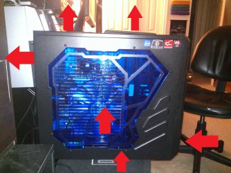

OK yea so flipping the top fans did nothing but pus the hot air back down tot the bottom of the case and made my CPU temps higher.
Really it's the NB and VRM heat sink I'm worried about. cpu and gpu within 2C of eachether dosent make a fifference but the difference between the nb and vrms is quite a lot.
Solar you have blower GPUs tho that blow the exhaust out of the case rite?
Yes everything is blowing through the back 1x 200mm on the top 2x 120 Corsairs SP's in the front blowing in 1x 240mm side panel blowing in Synthe Mugen slipstream 2000rmp blowing on the GPU's
2x Corsair SP on the RAD I don't have not one fan blowing out the top or side but the case is so big though the AIRFLOW is insane Thermaltake Element V Big case so that is why I got mad flow :cool:

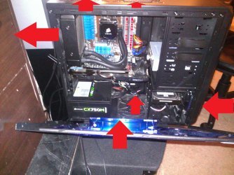

that's what im trying now. im trying my old fan and a single 120mm at the top pointed on the NB and VRMs. the fans are fine, its just the plastic its attached to that creates the loud noise. I have 4 fans 2 200mm ones ad 2 120mm ones. all of the are loud like that.

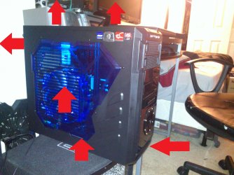

ok so heres what ive decided to do. for now im just going to leave my old 200mm side fan on. its not as fast and dosent move as much air, but it works.
in the future, I most likely will mod my side panel. ill make a clear or maybe smoked window and ill either turn the rear top fan upside down to intake air or buy a small 80mm fan to put on NB. than ill buy some cold cathos to make up for the lighting. I think that will make it quieter and prettier. but first I need the money. so its a future project.
