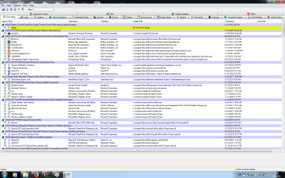

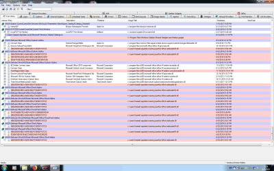

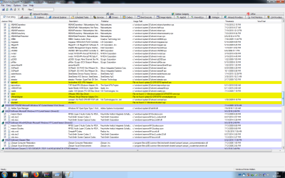

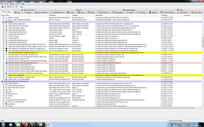

I also keep getting the the application was unable to start 0xc0000142 error and i've tried many solutions to no avail. This are the highlighted portions from Autoruns in the attachments
