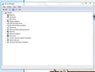

Can you post an image of the Device Manager, please.

here it is i didn't know exactly what you wanted to see within it

The point is, it eliminates one possible cause for problems. All of your devices/drivers look good.

yeah the device manager is one of the things I checked in my routine if you will. I have a microcomputer tech degree from years back. When vista hit the market from the first time I booted it I hated it and that has never changed to this day, along with hating it I fell away from keeping my education level to the new OS's when they came out. So in the meantime I'm asking questions again. haha.
