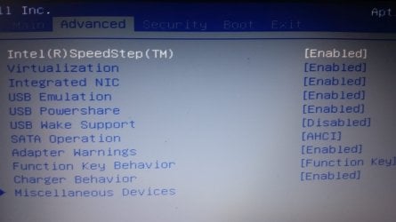

Hi, i think its enabled? Here's a picture of the bios menu.
I really am not an expert in these matters.. I understand most things but i just cant seem to figure out problems..

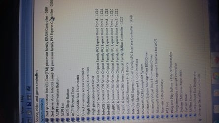

Another picture from my device manager just in case:

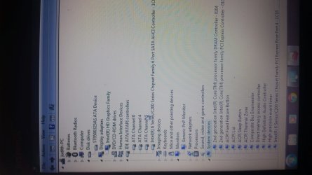

Been trying to get to understand how to do it, but you mean there are multiple chipset drivers?
Edit: including picture of system devices.

When you go into the Bios you need to go to the Advanced Tab to see if it is Enabled ...
You do have all the Chipset Drivers Installed ...
I have really bad eye sight and can not see your first Screenshot clearly ...

Im sorry for those pictures then, will try to do my best.

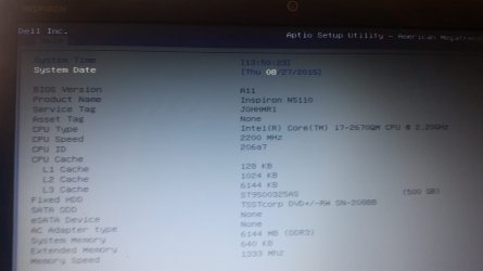

Everything i can find under Advanced is enabled. Here is another picture to confirm.
Im desperate...:(

Hello KrmLaaz,
The information you are looking for could be in "Advanced -> Miscellaneous Devices".

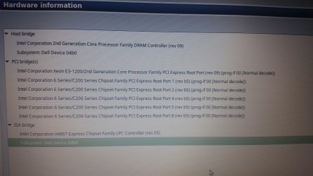

Hi, im back. Last post for tonight gotta sleep. :-)
So i've tried the linux startup and checked through sysinfo. All i got was a VGA compatible controller with under that a intel corporation 2nd generation core processor famility integrated graphics controller (Rev 09) ( Prog-if00 [VGA-controller].
Subsystem: Dell device 04ca.
Well here are some pictures i took.
I also got some new info i didnt know it would matter, for a while now my AC adapter for the N5110 (130W) isnt functioning as it should. Its plugged in but NOT charging. Ive checked if charging was disabled in bios but it was enabled. The Adapter doesnt get recognized in the bios but my other dell charger does, but thats a 85W ( i think ) so its not good enough.
I really hope the nvidia chip isnt broken or anything, they just replaced it last year!
Well thanks again, i really really do appreciate this help. (And linux looks kinda awesome.)

It is looking as if the Motherboard has become faulty again ....
