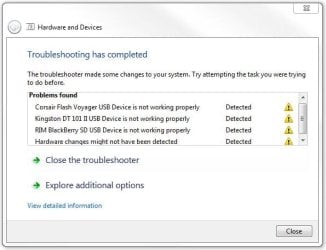

After a MS update I noticed that one of my SATA drives dropped off as if it went bad, the indication for this was that it became inaccesable. I connected the drive via USB and still could not get into the drive. I connected it to my XP OS and presto it was back and fine. When I rebooted I noticed another drive formed a yellow BANG<!> sign, then another and another until all my drives besides the drive that contained my OS droped off.
After pulling my hair out for hours I was able to determin that without a doubt it was not my hardware as everything worked on my XP OS. I rebooted into WIN764 and I downloaded all the service packs and all available updates. After getting the updates and rebooting all my SATA drivesshowed back up which was an improvement but I was still not able to access my flash drives even though the DEVMAN could see them just fine. I could not and still cannot access any external drives, air card or phone that contains a SD card or mass storage.
The operating system sees all on the machine but in the device manager it has the following error message.
"A driver (service) for this device has been disabled. An alternate driver may be providing this functionality. (Code 32)"
So, I have done everything I can think of and have spent at least 11 hours with MS
teir 1 tech support and they cant fix it either. We have been down every road I can think of. I will not do a system restore as it will take me back to April and I do not want to reformat. I want to pin point this issue and resolve it, not sweep it under the rug.
Also, another interesting fact to this issue is: I have 5 hot swapable bays on my rig, all is well until I pull one out. When I pull one out and then scan for new hardware it removes it from the list in DEVMAN and when I put it back in and re-scan it sees it just fine but give the old ERROR 32 again and what was once an accesable drive now becomes inaccesable. It takes a reboot to get them back.
Here are a few errors I found in my event log:
The driver \Driver\snapman failed to load for the device STORAGE\Volume\{9a59136f-04dc-11e0-959f-806e6f6e6963}#0000000000007E00.
The driver \Driver\snapman failed to load for the device STORAGE\Volume\{02d5794b-04f2-11e0-92fe-806e6f6e6963}#0000000006500000.
The driver \Driver\snapman failed to load for the device STORAGE\Volume\{9a331575-9085-11e0-96bc-806e6f6e6963}#000000AA606B0800.
The driver \Driver\snapman failed to load for the device STORAGE\Volume\{02d5794b-04f2-11e0-92fe-806e6f6e6963}#0000000000100000.
The driver \Driver\snapman failed to load for the device SCSI\Disk&Ven_WDC_WD64&Prod_00AAKS-00A7B0&Rev_01.0\5&22bede4e&0&000000.
The driver \Driver\snapman failed to load for the device IDE\DiskWDC_WD1002FAEX-00Z3A0___________________05.01D05\5&5c6cfd6&0&1.1.0.
The driver \Driver\snapman failed to load for the device IDE\DiskWDC_WD1001FALS-40U9B0___________________20.04F20\5&2ea7e938&0&0.1.0.
{This is my OS drive}
The driver \Driver\snapman failed to load for the device IDE\DiskWDC_WD3000HLFS-01G6U4___________________04.04V06\5&2ea7e938&0&0.0.0.
Please help me.
