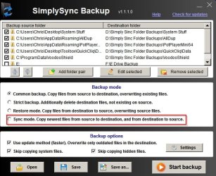

If you mean just add newest files rather than compare existing files for changes see this:
SimplySync Backup
