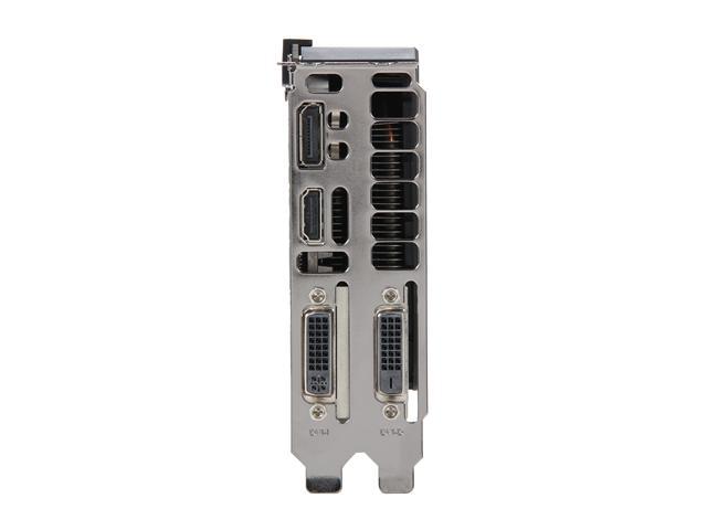

I really think it's something about my GRAPHICS CARD which is why this is on this topic.Let me explain a few things which im not sure if they are important but probably are.Before my pc was getting fixed one period i couldnt watch with hdmi until i do this: go to device manager and there i had 2 things on display adapters:nvidia card and some intel thing.
It would be helpful if you would provide your system specs in detail. Brand and model of your PC or laptop. A screenshot from Device Manager with the "Display Adapter" item expanded would be particularly useful.
But just from your comments above it suggests you have a "discrete nVidia graphics card/chip" in your machine, along with the built-in Intel HD Graphics that normally is available with modern i3/i5/i7 Intel CPUs.
The Intel HD Graphics (from built-in CPU) corresponds to the motherboard built-in video connectors, which are up toward the top (when you look at the back of the computer standing vertically). There might also be other video connectors, like VGA and/or DisplayPort and/or HDMI. But all of these would be associated with the onboard Intel HD graphics. All of these video connectors are managed by the Intel HD Graphics Family driver.
In contrast, down low (again as you're looking at the rear of the computer standing vertically) you would see the nVidia graphics card connectors, down in one of the perhaps 4-7 expansion slots available. Typically the top PCIe-x16 slot is where the graphics card would be inserted, so it's probably at the top of the 4-7 expansion slots (that go all the way down to the bottom of the case, when viewing the rear of the PC).
The discrete nVidia graphics card would also have its own video connectors. Depending on the model of card it, too, could have VGA, and/or DisplayPort, and/or HDMI, possibly multiple of these. But this card and all of its connectors are managed by the nVidia Graphics Driver... which is completely independent of the Intel Graphics driver which controls the motherboard's video connectors.
You've sort of described how you're trying to cable things, but you need to be precise and accurate. Are you trying to connect the PC to both a monitor via one HDMI cable, and a TV via a second HDMI cable? As I described, the "top HDMI connector" is from the motherboard, and is controlled by the Intel HD graphics. The "bottom HDMI connector" is on the nVidia Graphics card, and is controlled by the nVidia graphics card.
Ordinarily, both of these graphics capabilities are NOT ACTIVE SIMULTANEOUSLY, if the BIOS is not configured to support both. By default, the BIOS graphics configuration would normally use the built-in Intel graphics unless there is a discrete graphics card discovered to be present in which case the INtel graphics is disabled and the discrete graphics card is enabled. If this is how the BIOS is currently set then this is why you're seeing the "lower HDMI connector" (on the nVidia graphics card) operational, and the "upper HDMI connector" (on the motherboard) disabled.
If this worked for you previously, before you brought your PC in for repair, my guess is that the machine came back to you with the BIOS reset to its default graphics configuration... which has "AUTO" set, meaning that if a discrete graphics card is detected then it is activated with the Intel built-in graphics disabled. I would speculate that there must be another setting, which supports BOTH Intel graphics as well as nVidia graphics, which is the only way it can be possible for both your motherboard HDMI connector as well as the nVidia HDMI connector to ever have both worked.
Ok... that's my speculation.
You need to provide details of your hardware, in order for that speculation to be justified and/or corrected or clarified.

Wow thanks for this,really got me thinking,im not that much of an expert when it comes to pc but i'm not completely ignorant,i uploaded my specs,i hope that's enough for you to see and this is a photo of device manager : View image: 1 , and this a photo of back of my pc : View image: 2 my fingers are pointing at the bottom hdmi cable which im using at the moment for my monitor hdmi cable)
And yes there is a hdmi cable which is one side plugged in my monitor and the other side on the hdmi bottom port,i bought a new hdmi cable which im using for watching movies from my pc to tv.I hope this is helpful enough for you.

Why did you bring your PC in for repair? Or was it for an upgrade? Exactly what was done? This is very significant information.
First, assuming you had the same ASRock Z77 motherboard before you got your PC repaired, the User Manual is here. On page 53 in describing the UEFI Setup Utility (i.e. the BIOS and how you talk to it and configure your machine's hardware), it describes the primary graphics adapter. It's either (a) onboard, i.e. Intel HD graphics which controls the upper video connectors from the motherboard, or (b) PCI, which is a type of expansion slot down at the very bottom of which your board has two, but which you are NOT using for a PCI video card, or (c) PCI Express (which is the default) and which IS the situation you have, with the nVidia GTX 660 installed in the topmost PCIe slot of which your board has three.
So, there is NO WAY you could ever have been using BOTH HDMI CONNECTORS SIMULTANEOUSLY... one of which went to your monitor and the other of which went to your TV. Impossible.
And your Device Manager screenshot shows exactly that, i.e. only nVidia GTX 660 graphics, and NO INTEL GRAPHICS. So the only video connectors possible are from the GTX 660 card. If you have the card I think you have, it is "double wide" meaning it takes up two expansion slots and looks like the following:
Is that correct? If so then this is a very powerful card and can actually support output to both your monitor and your TV... from this card's connectors. You don't need to be attempting to use that second upper HDMI connector from the Intel graphics and motherboard... which won't work anyway.
You simply need to buy a different cable. The GTX 660 card has one HDMI connector, along with a DisplayPort connector. Either of these can be used to feed audio+video to your monitor and also to your TV. But since your TV most likely has only an HDMI connector it must be connected to using an HDMI cable at that end. Your monitor probably has multiple optional digital connectors: HDMI, DisplayPort, or DVI. I don't know if you're using your monitor for sound, feeding the speakers in the monitor via the HDMI cable you're currently using, or if you have regular external speakers that you're using for sound so that you're actually only using the monitor's video capability through that HDMI cable.
Anyway, you simply need a new cable: DisplayPort -> to -> HDMI, with the DisplayPort end of the cable plugged into the DisplayPort connector on your GTX 660 graphics card at that end, and the other HDMi end of the cable plugged into your TV. Bingo, presto. You now have TWO DISPLAY DEVICES SUPPORTED FROM YOUR GTX 660. Windows and the nVidia drivers will support these two devices, as Monitor#1 and Monitor#2 in "extended desktop" mode. You will be able to use either display for anything you want to send to each, dragging windows across the two of them back and forth as you desire.
So let's summarize:
(1) remove that top HDMI cable going to your TV. It is worthless, and that top HDMI connector from the motherboard is disabled and inoperative, and cannot be used period.
(2) Depending on the digital connector options on your monitor, and where your speakers are, you just need to get the proper cable to support your monitor. If you want both audio and video from that monitor then you'll need to feed it through either an HDMI or DisplayPort connection, both of which support both audio and video. And the other end of the cable can either be HDMI or DisplayPort at the GTX 660 end, because again both HDMI and DisplayPort connectors provide both audio and video.
On the other hand, if you only need to provide video to the monitor because you have external speakers connected to the Realtek HD Audio connectors on the motherboard (probably the lime green connector, for L/R stereo, or perhaps multiple connectors if you have a multi-channel audio speaker setup) then you only need to get video from GTX 660 to the monitor. So now you can use HDMI or DisplayPort or DVI connectors on the monitor, and a proper cable so that at the other end it connects to either HDMI or DisplayPort or DVI on the GTX 660.
(3) Depending on which GTX 660 connector you used for getting video (and possibly audio as well) to your monitor, you now simply use either the remaining available HDMI or DisplayPort connector on the GTX 660 to feed your TV. Both of these can provide both audio and video, if you're going to use your TV's speakers.
Am I clear?
One final caveat... the DisplayPort connector on the GTX 660 can feed either DisplayPort connector on your monitor, or the HDMI connector on your monitor. Similarly, the DisplayPort connector on the GTX 660 can feed the HDMI connector on your TV, if that's the way you want to connect it. You just need the proper 2-ended cable, with the correct connector type at each end. These are inexpensive to buy, but you need to get one with the proper connector at each end for your need.
However the HDMI connector on the GTX 660 can only feed an HDMI connector on the monitor or TV. You cannot feed a DisplayPort connector on your monitor from an HDMI connector on the GTX 660.
So just think about how you want to set things up, and where the speakers are going to be for sound from either monitor or TV depending on what you're playing, and that's the cabling you'll need. Both HDMI and DisplayPort cables can provide audio and video.
Using the DVI connector on the monitor (if you want to use it) does NOT provide audio, it only provides video. And it must go to one of the two DVI connectors on the GTX 660.
You have a powerful video card, and you will likely need to use nVidia Control Panel along with Windows Desktop Properties to configure the two connected display devices the way you want. You need to specify which is the primary Windows monitor #1 or #2, etc. But you will be able to do everything you want.

If i remember correctly i brought it because I couldn't start pc properly,just wouldn't load and they brought it back to me and said the problem was in dust that covered it. And about 2 hdmi connections u are stating is impossible,you're probably right,i dont remember exactly but i think my monitor had a different cable or something like that before they brought it back,im not quite sure,i just remember that i couldnt start watching on my tv until i enable intel on device manager and i disabled it when i wanted to get back to pc. Here is a closer picture of those ports,I guess u re reffering to this : View image: 3 .

newer (in the last five years) MOBOs that allow both onboard graphics and a GPU card to work simultaneously.
Onboard graphics (IGP integrated to the motherboard as a part of chipset) is almost history; nowadays (in the last few years) the Integrated graphics is on-Processor Graphics, like AMD APU or Intel HD Graphics.
I confess I still don't see evidence of the Intel on-CPU graphics for you to even possibly be able to enable or disable. Device Manager only shows the nVidia GTX 660 in Display Adapter.
But your description further suggests you never actually watched BOTH TV and used your PC/monitor at the same time, simultaneously. It sounds like you have some method of doing one or the other, and switching back and forth through some enable/disable of Intel Graphics in Device Manager to accomplish that. From your screenshots I just don't see how that's possible, or what you actually used to do.
In any case, if you do actually have the type of GTX 660 that I showed in my picture, then you certainly CAN run BOTH the TV and your PC monitor simultaneously, doing nothing extra or special when you want to do that. Your system will simply support the TWO display devices simultaneously, as part of a "double-wide" Windows desktop. Both of these display devices can therefore be used as output from Windows programs.
However your mysterious description of what you used to do before bringing the computer into the shop for repair still concerns and confuses me, since maybe I don't fully understand what "watch TV" actually means to you.
I don't know what that cable on the right could be. It's not part of the graphics card set of connectors, at least not according to my picture. Maybe it's for external power, instead of being fed the additional power it needs internally with a 75W PCIe cable from your power supply. I don't know. You're not showing the entire card and you haven't provided the manufacturer of that graphics card.
If you could take one more picture showing the entire WIDTH of that card, so that all connectors could be seen, that would be most useful. It's entirely possible that the picture I posted is not exactly your GTX 660, but hopefully since this latest picture does show two DVI connectors it does strongly suggest your card is truly double-wide (i.e. takes up two slots) and therefore probably will have all the connectors I've described... HDMI and DisplayPort along with those two DVI connectors shown in your latest picture.
And thank u so much for your help,I'll buy that cable in 2 days and hope it's fixed :)
Just remember, this will allow you to run BOTH the TV and your PC monitor simultaneously, which is what I have assumed you're really wanting to do. There will be no need to enable or disable anything in Device Manager when you want to "watch TV", whatever that means.
But it's possible this new TWO DISPLAY configuration (once you get the proper cable) will give you new flexibility or possibilities, so be prepared for a likely need to conceptually reconfigure your mind to how you do whatever it is you want to accomplish. Again, you'll likely need to use both nVidia Control Panel as well as Windows Desktop -> Properties (from right-click on desktop) to get the TWO DISPLAY configuration set to your liking.

Just a couple of things that may help understanding ...
If the On-board graphics (Chip or On-die) are disabled in the BIOS, I believe they would not show at all within the Device manager in windows.
The other thing is that as we are talking about an nVidia discrete Graphics card, it may well be that the DVI ports (or at least the one type that are fitted), will include the sound as well as Video, (as long as they use a suitable DVI-HDMI Cable/Adapter), which could increase options for the TV
As I mentioned earlier after looking in the User Manual for the motherboard, there didn't appear to be any option to enable or disable onboard graphics as there commonly is, for example, in Lenovo Thinkpad laptops.
This is a PC desktop motherboard, and it simply allows specification of which ONE OF THREE possible locations for graphics hardware should be looked at first. And the PCIe-x16 slot is the typical one to be used, as that's where today's graphics cards go. And that's also what this machine has in it... an nVidia GTX 660 from some still unknown manufacturer, but nevertheless a GTX 660 obviously with two DVI connectors and almost certainly also with an HDMI and DisplayPort connector.
I don't know what OP had before, or how "watching TV" was accomplished by "disabling and enabling something in Device Manager" when there obviously is no Intel Graphics shown in Display Adapter right now. So there are still unanswered questions about the before situation.
But right now, that GTX 660 used properly and with TWO CABLES going to the monitor and the TV is the clear solution to the assumed objective of allowing BOTH DISPLAY DEVICES TO BE USED SIMULTANEOUSLY and without any fooling around in Device Manager to do that.
The TV is simply connected with an inexpensive standard cable that has HDMI at the TV end. The other end can either be HDMI or DisplayPort. HDMI-to-HDMI is obviously a universally common cable, and DisplayPort-to-HDMI is an inexpensive optional order (around $8USD). Either cable supports both audio and video, so the TV's speakers could be used if that's what was wanted. Alternatively audio from the PC to external speakers or sound system could also work.
The monitor is simply connected using a variety of optional cables, if only we knew what that monitor was and therefore what its connector options were, and also whether or not the speakers in the monitor are to be used or again whether external speakers are being used. For video-only, either DVI, HDMI or DisplayPort connector at the PC end of the cable would work. For audio+video either HDMi or DisplayPort connector at the PC end should be used (trying to provide sound via DVI is totally unnecessary and expensive, when a simple HDMI or DisplayPort cable is the obvious solution). The monitor end of the cable can also vary, depending on the monitor and depending on whether audio from the monitor's speakers is to be used. But both HDMi and DisplayPort at the monitor end of the cable would provide both audio and video, or just video.
Only caveat is that a DisplayPort connector on the monitor CAN ONLY BE FED FROM DISPLAYPORT CONNECTOR ON THE GTX 660. You can't feed DisplayPort on the display device from HDMI on the graphics card using a standard inexpensive 2-ended "passive cable" (although it is technically possible with an expensive "active adapter").
I think OP has enough info to make progress here. Once the needed second cable is obtained, I'm sure this thread will continue on with some more questions and answers.

Im not actually sure what part do u want me to take picture from.And 'watching tv', i only used hdmi earlier to watch movies i downloaded on my pc,therefore i didnt even need both pictures(on tv and on monitor). I dont even need it now coz all i want is to watch movies on tv for better picture.Im positive that i watched it before with hdmi end on both plugs(pc and tv) but im not exactly sure to be honest even what monitor i had,because i have 2 monitors in my house but im pretty sure i used this one as well when i was able to watch it.I dont know what to tell you about intel,thats how it happened,i would just enable intel or disable nvidia and picture would went from my monitor to tv and after that i would just go other way around to switch it.

Yea so I just took dvi cable from my other monitor from other pc and i disconnected the hdmi cable connecting my monitor and pc and put the dvi( there is dvi and hdmi plug on my monitor) and connected the other end in my pc so i had that hdmi plug on pc available and connected my hdmi there,set up a few settings in display and voila,its working,both simultaneously.Thank you @dsperber for all your help as well as everyone else for helping me with this.I guess tomorrow i can buy a cable with both dvi ends as well as one with dvi and hdmi end,it would make no difference
