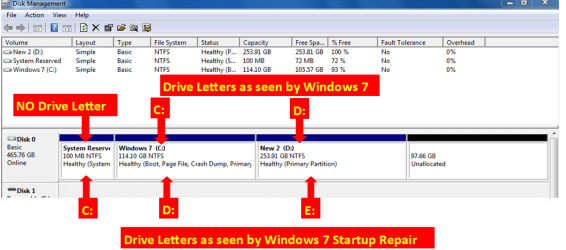

I can goto D: and see what looks like all my HD data, and when I goto C: it very difenitly labels it as C: "C is SYSTEM RESERVED"
The drive letters are OK.

There seems to be no Active, Primary Drive. Try booting from System Reserved Drive if you can if booting from C fails.
There is an excellent shareware boot disk of Acronis Disk Director Suite and another free one of Partition Wizard that too is excellent. Both programs can be downloaded from the Net.

Download Partition Wizard Free boot disk Free Download Magic Partition Manager Software - Partition Wizard Online
Burn the .iso, don't just copy it to a CD.
Boot with the CD and remove "C" from the system reserved partition. Be sure it is still marked active.
Next change the Windows/data partition to "C".
