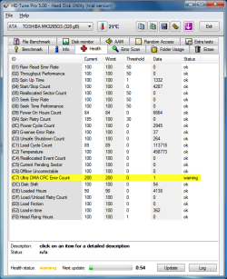

Today it made it again can it be my hard drive? is this SMART data fine (the CRC error ocurred long time ago with an old motherboard)
attachment.php
