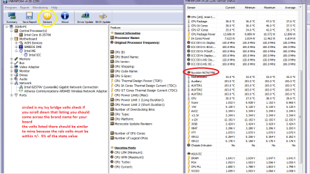

Hello and welcome Darren mate one or two things can you do this http://www.sevenforums.com/tutorials/179397-dump-files-upload-sevenforums.html
and run Speccy and see what the temps are Speccy - Download
and read this ditty of mine
UsingHW Info PSU
Download HW Info and pick the right bit version -
HWiNFO, HWiNFO32/64 -Download -(copyand paste this site into the search bar) If you donot need the running information in the smaller right hand panel close it. Inthe left hand window click on the + for the individual device groupings andthey will open out to the various components.
Go on opening out further until you get to the device itself. click on it and itwill highlight. In the right hand window there will be a very detailed descriptionof that device as in brand, speeds model number etc etc These are very detailedand are just what is needed for searching for drivers etc.
To get the PSU volts you need to select the Sensor button circled in yellow inthe pic for PSU testing do the same and scroll down the readout as in my pic towhere it has Nuvoton = yours might be a different section name / title. Postback apic of that please.
If you want a more definitive test see this
http://www.sevenforums.com/tutorials/301799-psu-test-dc-output-voltage.html
but pleaseonly use a digital multimeter and not an analogue as they inject typically 9vinto a circuit to test and into a 3.3v or 5v rail - not a good idea!!see thepartial pic of the correct sort of meter in that tutorial. details if you scrolldown that listing.
Now a good reference article is this
Voltage Rails - Power Supply 101: AReference Of Specifications it will explain in detail what thevoltages are and functions of the PSU
The pic shows my Ivy Bridge the section on your machine may be titled differently to Nuvoton but it is the section where you can find Vbatt

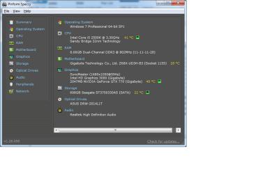

I ran speccy as you suggested and here are the temperatures I got while gaming:
Here are temps while just browsing the internet:

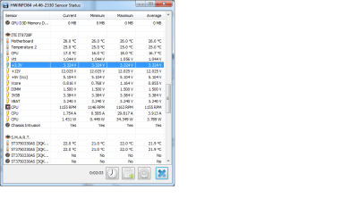

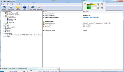

Here is the screenshot from HwInfo:
Update: Here is another screenshot of HwInfo - I realized you may want that as well
I'm not sure if I screenshot the right section here, so let me know and I'll take another screenshot. Also should I have taken this while gaming or just idle?
I took a quick look at the more thorough test you suggest but I don't have a multimetre and I'm not sure i'd be competent enough to complete the test.
I'm going to take a look at the other article you linked tonight on voltage rails tonight as well. I figured I'd reply with my results as soon as possible and see if you had any other advice.
I'm really hoping I can get this issue resolved as I feel like I wasted 600 bucks on my GPU and PSU. Also I edited the main post to clarify that one time I turned the computer on and the GPU fans were super load and I had no display. I ended up opening the case and removing and then reattaching the graphics card. Somehow that resolved the issue but I don't understand how.
Thanks for the help so far. Much appreciated.

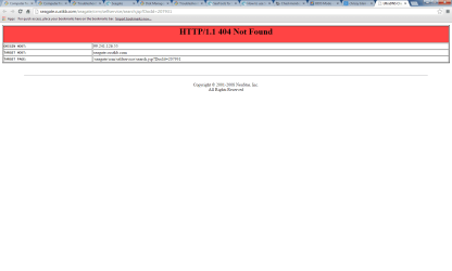

So I'm following Greg's suggestion and working through the troubleshooting steps. However, I'm currently stuck on the first step. I downloaded the ISO for Seagate HD and burned it to a CD. I then booted off the CD and the diagnostic tool opened up, but I was unable to move my mouse. I pressed enter on my keyboard to try and start the diagnostic tool since my mouse wasn't working and I then got a message saying no hard drive was found. So I'm not really sure where to go from here.
As for step 2, I've already downloaded and ran Memtest 86 previously and I had no errors. I'm not sure exactly how many passes I let it run - but I think it was at least 5 which took about 5 hours or so if I remember correctly.
For step 3 I had my friend look at my computer recently and he said everything looked like it was set up properly. By swapping RAM sticks do they mean use different RAM sticks, or do they mean moving the ram in slot 1 to slot 2 and vice versa?
For step 4 - Is Core Temp any different than the HwMonitor? Just wondering If I need to have another program to monitor temperatures or not. I will gladly download it if you guys think it would help.
Step 5- I already had Malware Bytes so this was pretty easy. I usually run it once a day and it hasn't found anything.
Step 6- I did try disabling my AV temporarily in a little while ago and the game still crashed. Do you think its worth uninstalling it? Or should I just disable protection temporarily and play games to test it out.

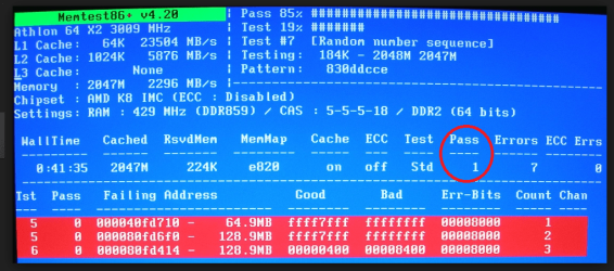

With the RAM testing Darren it might be an idea - painful as it may be to run again and make sure it is at least 8 passes see pics and my ditty here
MEMTEST
http://www.sevenforums.com/tutorials/105647-ram-test-memtest86.html this one you will need to make abootable disk set the BIOS to optical(or USB if preferred) boot the machine and let it run for at LEAST 8 passes unless the errors come up straight away. Takesfair time to complete and some leave itrunning overnight.
NB
When you run the memtest ifthe errors come up straight away a in my pic then you will need to test each stick if you havemore than one and if it is only onethen test again in another slot because it could also be a fault on the board.
So for example two slots A & B /sticks 1 & 2 if the errors come up remove all sticks
Then try stick 1 in slot A if noerrors install stick 1 in slot B if no errors then install stick 2 inslot A if no errors then install stick 2in slot B. If there were errors to start with one of these combinations willhave to show errors.
Doing this will narrow down the problemslot as it could be the slot and not the stick or even a specific slot andstick combination. A lengthy process but only necessary if you get errors.

Okay thanks ICit2lol - I'm going to run memtest86 again tonight and I will post the results tomorrow.
Question: Am I able to take a screenshot while running memtest or will I have to use my phone or something to take a pic? This is if I get errors of course.
Also does anyone know how I can get step one of Gregs Troubleshooting guide to work? I mentioned the issue I'm having in my last post and I've been unable to resolve it. I did however, run a Chkdsk and I'm assuming there were no errors because my computer rebooted when it was completed and there was no report of errors.

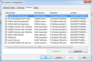

You have a ton of useless items in your msconfig Startup. Why would you think they should be let run to spy on you and use resources when they are not needed at all? I would uncheck all except Avast. Then do the same in Services tab after checking the box to Hide All MS Services.

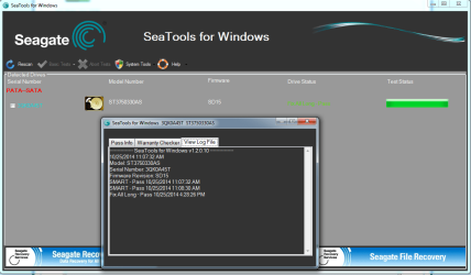

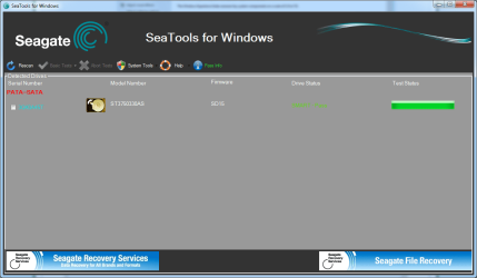

Please explain the problem with Step 1? What make of hard drive do you have? You can google the serial number under Disk drives in msconfig or System Information to find the brand. Then use the diagnostics provided for that brand from Hard Drive Diagnostic Procedure

gregrocker - I honestly didn't think any of that stuff was spyware. I was assuming they were all legit since they are all intel and nvidia and I haven't downloaded anything on this computer besides anti virus and gpu drivers. I will uncheck them all except Avast as you said.
the problem with step 1 is that I downloaded the Seagate ISO in the link you provided and burned it to a CD. After booting off the CD the application opens but I can't move the mouse cursor. So I tried pressing enter to start the diagnostic test and I just got a message saying "0 hardrives found" or something along those lines. My HDD is a Seagate Barracuda 7200.11 ST3750330AS. When I ran Chkdsk I had no issues though.

I used Windows Image burner and I clicked the checkbox to verify the image was correctly burned.

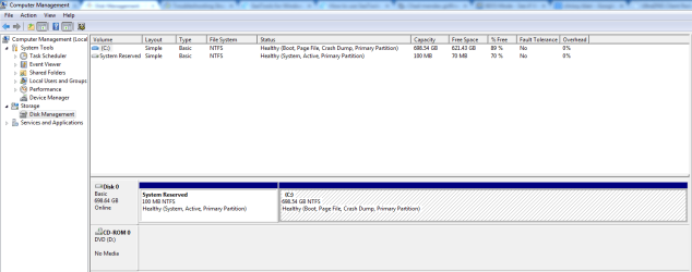

Do you have UEFI BIOS? Look at Disk Mgmt to see if there's a EFI System partition. If so set BIOS to CSM to allow Legacy BIOS boot.
Try bootable test again.
Try running installed Seatools then. If possible slave the HD to another PC so System Files aren't running.
Darren mate just take pics with a digital camera and snip the image put it in pictures then add it to your post using manage attachments (below your post).

Okay, so I ran Memtest86 over night for 9 passes total and I got 0 errors. So I'm going to assume my RAM is alright unless 2 Memtests and the Windows Diagnositics both missed errors.
gregrocker - Not sure if I have a UEFI BIOS. Is Disk Mgmt an option in the BIOS? I can try the SeaTools for sure instead as well. Update: Nevermind, I found a tutorial here:
BIOS Mode - See if Windows Boot in UEFI or Legacy Mode
And it looks like I have a Legacy BIOS. So I guess I'm stuck using SeaTools instead of the bootable CD.
ICit2lol - Thanks for the tips. I didn't end up taking a pic because I had 0 errors luckily hehe.
