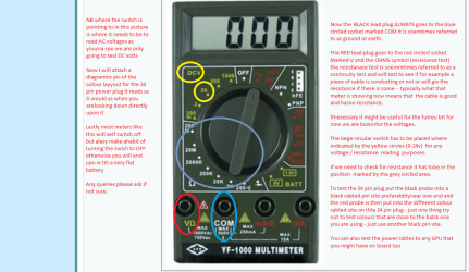

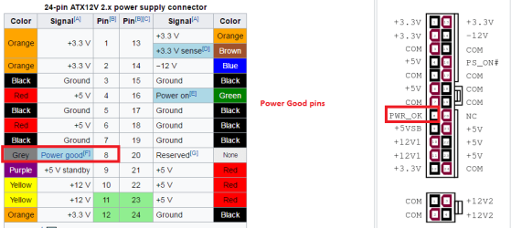

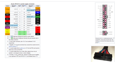

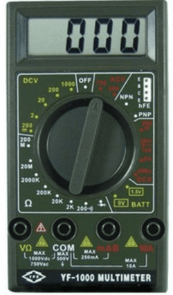

Ok well the PSU my friend you can still test with a digital multimeter they are very cheap and you only need to power the machine on and test the leads especially the 24 pin plug and I would be very interested in seeing what the voltage is if any is at pin 8 (grey cable) on that plug.
That is the POWER_GOOD signal pin and if that does not get a 5v signal from the PSU then nothing will start up as it is a safety measure built into the PSU to stop unsafe voltages (over or under) being supplied to the board. Now you can see from my little ditty that the tolerances for the voltage rails are very fine at 5% positive or negative of the required voltage.
I have attached a pic of the 24 pin plug colour coding and it applies to all the other power cables in your machine. The choice is yours to do this and for the sake of doing this (takes a few minutes if that) you could be taking a risk with unsafe voltages.

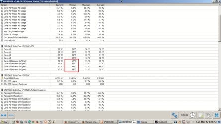

We have two conflicting points here - your assertion that temperature is fine and your report that you are hitting 75C, which is not fine. Here's a quick and easy way to put the issue to bed though, just run hwinfo64 and keep an eye on the "Distance to TjMAX" area, which I have outlined in a red box. Let us know what the smallest number you see in the minimum column after using the machine for a while.
HWiNFO - Download
If you never get closer than say 15C to TjMaxx, then yes your temps are not the issue. In that case I would swap out the power supply if you have not done so already. It was smart to remove that second drive. If your temps are fine after running hwinfo64 and you still shut down with a different power supply, and you've done a full virus scan, and you have no checkmarks in device manager, then my money is on the motherboard, which is impossible to diagnose other than to swap it out....
Hi there , How are you doing?
Here I am after a long time.
Now I have time to start troubleshotting.
I am ready to test the PSU.
I got the multimeter in the pic.
Would you please explain a little bit how to proceed with this one?
Hopefully we'll get this sorted out
Thanks a lot

Ok mate have made up a pic for you and if you have nay doubts or queries please ask.
This is a good reference https://en.wikipedia.org/wiki/Power_supply_unit_(computer) the 24 pin plug is copied from this and there is a pic of a dedicated tester at the bottom of it.
Just remember the voltages are not inherently dangerous themselves only that they are supplied a high current and if you have ever accidentally shorted a car battery then you will know what I mean
