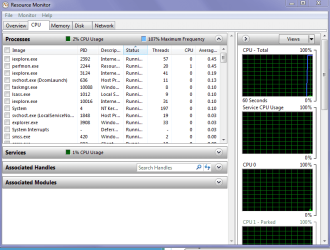

Hello and welcome Crazyripper mate > Start > type Resource manager > post back what you see yu should get something like my pic (scroll down til you find the culprit/s.

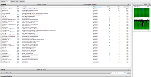

Hi thank you for the reply
I have noticed for the first 3 minutes when i boot the computer up cpu stays relativly normal however after that is goes straight up to too 100% i have written down the highest one which is as follows >>> svchost.exe
i have also attached a screen shot for you
do you know how to fix this issue? i have been trying to fix it all night

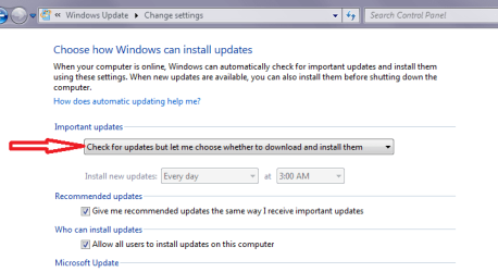

Good job mate at the moment it seems that the updates are all over the shop and it seems to have started with the the release of 10 - I stand to be corrected though. Now if you take my advice I would set the updates to let you know but let you decide which to download and install especially if you want to avoid that Windows 10 stuff the KB 3035533 is one in particular to avoid because if you install it - it will nag the life out of you . Beware though there are more:sarc:
See my pic of my set up
