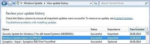

These are symptoms I'm having on a relative's Acer One I've just clean installed 7 32-bit Starter on. The updates problem could be down to the Windows Update Agent automatically updating to 7.6.7600.320 (notice the 7600 pre-dates Service Pack 1 so this could be an indicator). The System Upgrade Readiness Tool is apparently supposed to fix this but so far I've had no joy.
It's worth trying that fix for updates first then tackling the slow IE loading time after all other updates are installed.
Personally I'm trying to upgrade the One to W10 but that's stuck at finding updates too prior to even installing, so I may reinstall 7 again and change the Update settings to see if I can block the Update Agent upgrade so I can actually install Updates. This is another possible fix you may want to try.
