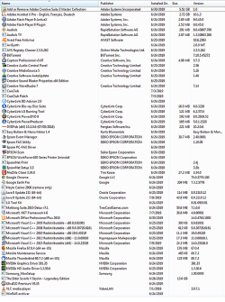

Here is a list of all programs on my computer:
