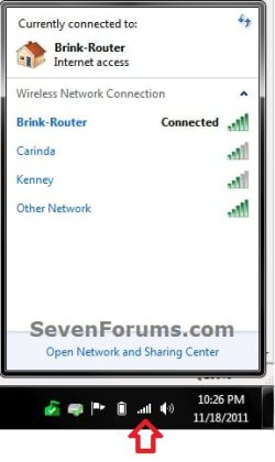

This will show you how to create or download a Connect To shortcut that opens the same "Currently connected to" pop-up as when you click on the Network system icon on the taskbar.
EXAMPLE: Connect To

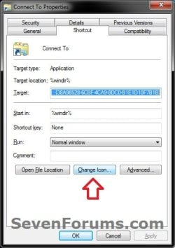

4. Right click on the new Connect To shortcut on the Desktop and click on Properties.
5. Click on the Shortcut tab, then click on the Change Icon button. (see screenshot below)
6. In the line under "Look for icons in this file", copy and paste the location below and press Enter. (see screenshot below)
%SystemRoot%\system32\imageres.dll,-171
7. Select the icon highlighted in blue above and click on OK. (see screenshot above)
NOTE: You can use any icon that you would like instead though.
8. Click on OK. (see screenshot below)
