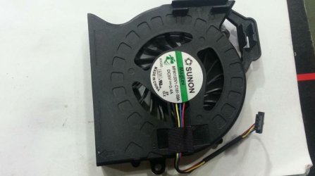

However, this information written on a sticker on the Cooling Fan/CPU fan/heatsink' sent by a person claiming that he is computer technician.
Sunon
MagLev
MF6100V1-Q032-G99
P/N:0HFMH9 Rev-A00
DC---0.4A
4BR01FAW10 3A EP
6.4CFM KCL
When I have made comparison between the information on the Cooling Fan sent by that computer technician, and the information on the Cooling Fan in my 'HP Pavilion dv6 Notebook PC-Maintenance and Service Guide)c02842252 below, I found there is no relevance at all between the two cooling fans.
There is no spar part number typed on the fan sent by that person.:confused:
Also, When I tried taking apart the first parts of my notebook, such as 'service cover', optical drive, and HDD, I found each of them have an HP spare part number printed on it.
Although I didn't get to the cooling fan, it could have an HP spare part number printed on it.
Since removing the defective cooling fan and replacing it with the new one will be more difficult to change as many parts of the Notebook have to be removed to get to it.
So, My questions are as follows:
Firstly: do think that I can go ahead to install that new fan. I don't want to try to take apart all the parts of my notebook, and when getting to it, and while installing the new cooling fan above, I'll face it isn't compatible or not working well.
Secondly: the new fan sent by that person is only single cooling fan, and there are no other parts, such as thermal material, so why is it said in the final step of To fix this error 'Thoroughly remove dust from all internal cooling components. as long as the fan is only a part?

The merchant insists on saying that cooling fan below is compatible with my HP notebook, although I don't see any HP spare part number printed on it.
Only this information printed on your cooling fan.
Sunon
MagLev
MF6100V1-Q032-G99
P/N:0HFMH9 Rev-A00
DC---0.4A
4BR01FAW10 3A EP
6.4CFM KCL
However, this information printed on my defective cooling fan
HP Spare part number: 641477-001
My questions are::
Firstly: do you think I can go ahead with installing the cooling fan shown below, although there is no HP spare part Number is printed on it.
secondly: could you please let me see the 'thermal compound', and 'heatsink'
I only have seen 'cooling fan' as it is shown below?

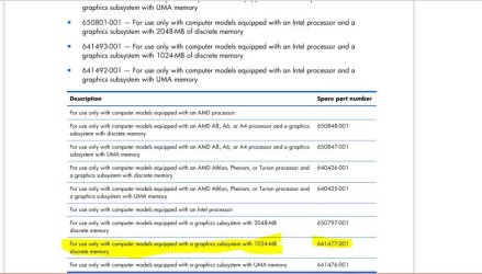

here is the service manual. looks like they are using thermo pads not paste would need to get the right kit depending on what processor and graphic sub system you have part numbers are on page 90 of the service manual for thermo kit and fan/heatsink. http://h10032.www1.hp.com/ctg/Manual/c02842252

Firstly: Although there is no HP spare part number printed on the cooling fan above, the merchant(who claims that he is a computer technician) insists on saying that it will be compatible with my notebook.
Even if the fan posted its image before had been installed very well, then maybe it wouldn't function very well as it is supposed since there is no HP spare part number printed on it, which means that it is not specified for HP Notebooks. When taking apart(removing the first parts, such as HDD, optical drive, and so on), I found ALL my parts have a sticker on which an HP spare number is printed.
Finally: Do you think I would need 'heatsink' and 'thermal compound' too? And an appropriate cleaning solution to remove previous compound. I am expecting that I will only need to replace the fan.

hi like i said in my post above the you need to use the part number from the manual choose the one that for your processor and graphic sub system. if you check the part numbers in google it will show it comes with the heat sink and fan assembly they are not seperate things. plus it shows it using thermal pads not thermo paste they are two differnt things. the best thing to do is take it laptop apart down to the fan heatsink assembly it could have the part number on it. then you will know for sure if fan is seperate from the heat sink.

I guess my post has mislead the OP, so sorry for that. Although it wasn't wrong, it seems to be not your case!
Please do as oscer adviced.

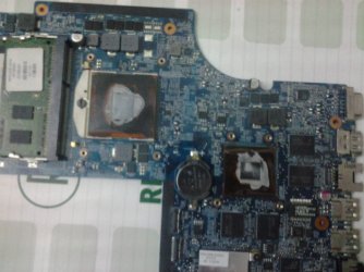

Firstly: If you see the images of my system board you will see there are no thermal pads at all. So I think I will need to apply new thermal compound on the top of processor and on the graphics subsystem
Secondly: there are old thermal compound on the processor and on the heatsink section that services it. Also, on the top of graphics subsyste m and on the heatsink section that services it.

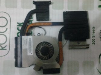

Thirdly: while removing the old fan from the heatsink, I found there was thermal tape which was torn. That material is easy o be torn. Can l find another one to reuse. Screen shot below
Finally: I was advised to clean the old fan with a paint thiner which is a liquid used to thiner paint-based oil and their use. I can clean the entire old fan and heatsink assemply with that material.

In addituon tom first post, i would like to to determine where the thermal tape which was torn while removing old fan from heatsink. The thermal tape is in the final screen shot, in particular in the thing/ object shown in the left side of the very top end in the screen shot below
