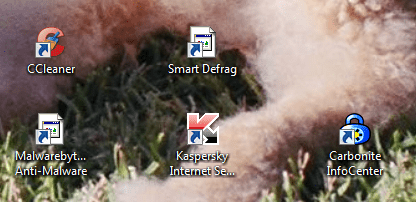

Problem: 2 desktop shortcut icons today suddenly reverted to "generic" shortly after starting up my system and after a routine definitions update by my security suite (KIS2011, fully patched). (And it may have been a coincidence.)
The MBAM real-time protection module was NOT running at the time, nor was SmartDefrag open, so neither program was loaded into the memory at the time.
Attached screenshot from desktop shows 2 "generic" icons where normal ones had been just a few minutes earlier. The shortcuts and the programs themselves still work fine, as they had for months on this platform. I have never seen this before.

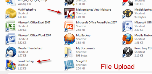

But here is what I REALLY don't understand:
1) If I open both programs (even from their generic shortcuts) the SYSTEM TRAY icon for both of them looks totally normal.
2) When I clicked on the "attach file" button at the KL forum to upload my screenshot of the desktop (see attached), the "File Upload" window ALSO shows totally normal icons. (see attached)!!!

1) I was able to restore the DESKTOP shortcut icons by doing a "change icon".
HOWEVER, they are still blank/generic in their source locatio,n and in start menu > all programs.
AND, I have not yet rebooted after correcting the desktop icons -- I have a feeling that they will revert back to generic when I do???

3) If I open either application, the icons they place in the system tray were/are normal, even before I had "fixed" the ones on the desktop.
3) BUT, they are STILL blank/generic when I look at them in the explorer start menu > all programs, even though I completely uninstalled/rebooted/reinstalled 1 of the 2 programs in question (which did not fix the issue).
5) HERE'S THE RUB: Last time I checked in C:\Program Files(x86)..., in their respective folders, I think the EXE files there were ALSO generic (for MBAM, the mbam.exe was generic, while the mbamgui.exe was normal).

MM,
The single icon reference in the tutorial is just if the shortcut's source was moved or deleted. Rebuilding the icon cache wouldn't help in that case. Only recreating the shortcut directly from the source would instead. That's all. :)
Nope, you would use the command exactly as in the tutorial instead. Using Option One in the tutorial will make it a lot easier to rebuild the cache though. Let's see how it does after rebuilding the icon cache before we suggest anything else though to hopefully keep it simple.
