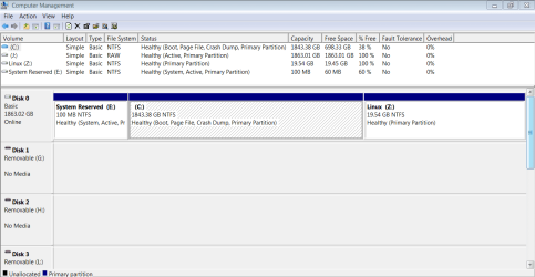

I noticed that my external hdd had an extra 100mb partition on it, I used partition wizard to merge the two partitions so it will be like its normal 1 partition, upon finishing the merge my 2tb external drive is now unreadable but the info is still on there, is there some way for me to make it so I can make it readable again? right now when I double click the drive it takes about 5 minutes to load then says the drive is unreadable. When I ran it through a partition recovery I can see the files are all still there and even open the files but I need to make it accessible again without the program. The files equal more than what space I have available on my hard drive or I would just transfer them like that. I have also tried un-assigning a drive letter then reassigning it but that didn't work either.

despite the fact that it shows no useful info that I didn't show before Ill do it.

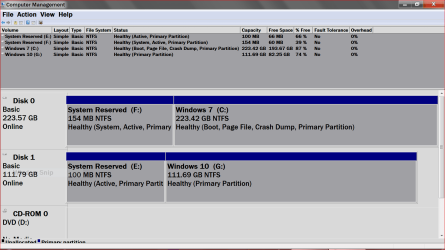

Thank you and yes it does show more.

you too, the only reason I even merged the two partitions was because its been bothering me since partition wizard put it there the first time (the 100mb partition) and since its just a storage device I didn't think it would mess with its ability to load. I think after this I will uninstall partition wizard and no longer mess with partitions, it doesn't seem to be my forte. I hope someone can come up with a solution to this, I have a lot of saved files on my hdd, video projects, photos and project for photoshop (almost the full 2tb worth)
