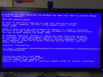

I’ve also gotten the occasional BSOD but no crash dumps are being created I think I have my settings right.

I do have a page file set up for my C drive and I've switched to capture a full dump now. I also ran the memory test and everything came out OK. I'll post the dump if there is one next time I have a crash.
Thanks again.
